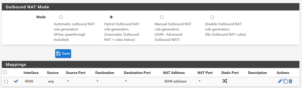

You know what is truly ironic ? I just discovered that pfsense is able to do PAT for IPv6 !
My problem is solved !
But it's ugly and I don't want to do that... Pfsense can do static NPT and PAT for IPv6, please add dynamic NPT, it's less ugly
