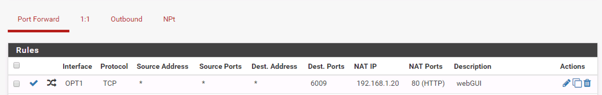

It looks like NAT works and firewall passes packets to 192.168.1.20 but there is problem sending response back.My Port Forward rule looks like this:
Interface: OPT1
Protocol: TCP
Source Address: *
Source Ports: *
Dest Ports: 6009
NAT IP: 192.168.1.20
NAT Ports: 80In Outbound I'm using manual Outbound NAT mode.

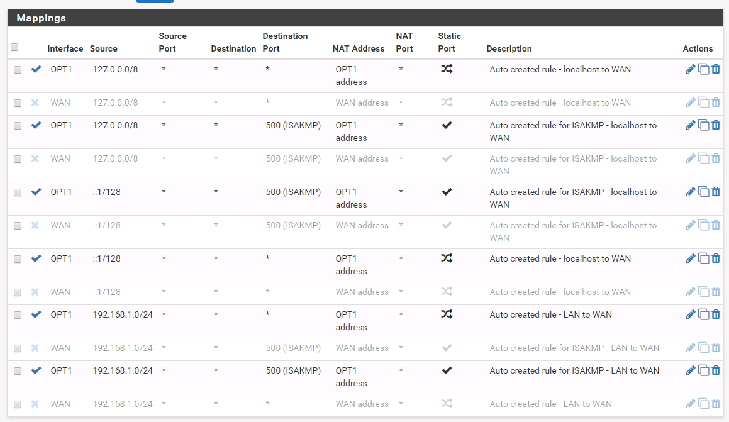

My Mappings (LAN to WAN and LAN to OPT1) looks like this:
Interface: WAN
Source: 192.168.1.0/24
Source port: *
Destination: *
Destination port: *
NAT address: WAN address
NAT port: *
Static port: Randomize source portInterface: OPT1
Source port: *
Destination: *
Destination port: *
NAT address: OPT1 address
NAT port: *
Static port: Randomize source portI've got localhost to WAN, localhost to OPT1 mappings also but I think they're not a problem in my case.

Outbound rules:
Port forwarding:

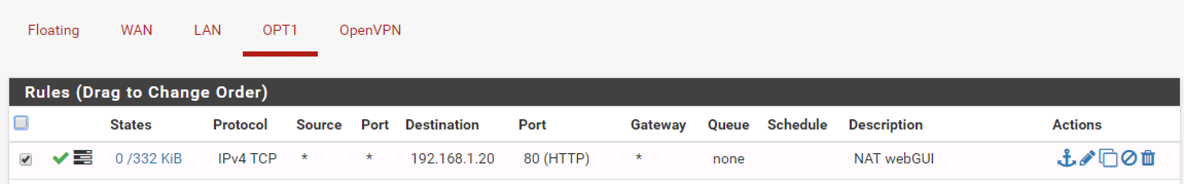

and connected Firewall rule:

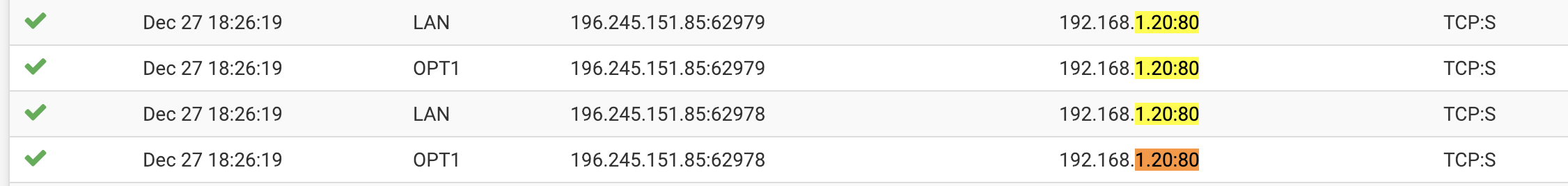

Firewall passes packets:

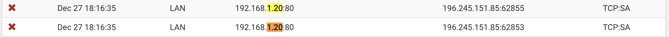

but blocks connections back:
and I dont know the reason because Im not filtering LAN to OPT1 connections:
