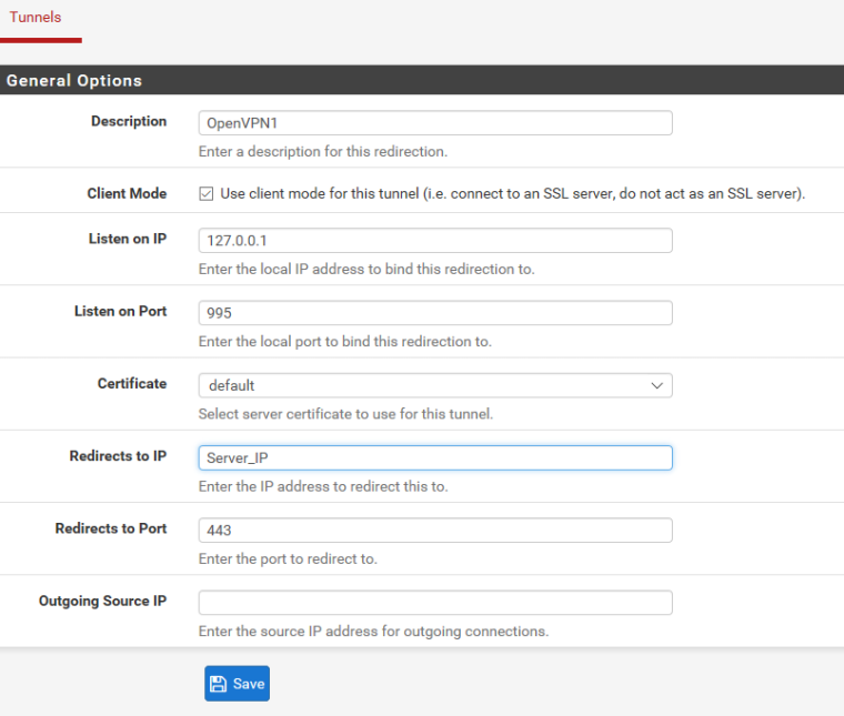

      I have now configured OpenVPN Client and stunnel from AirVPN.
      browse "VPN: OpenVPN: Client"
      Protocol: TCP
      Interface: Localhost
      Server host or address: 127.0.0.1
      Server port: 995
      Advanced:
             route Server_IP 255.255.255.255 net_gateway
      And with this stunnel configuration:
      I'm trying to configure load balancing now with exactly 4 same openvpn clients.
