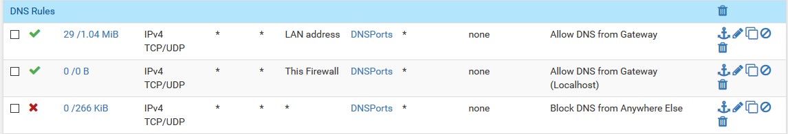

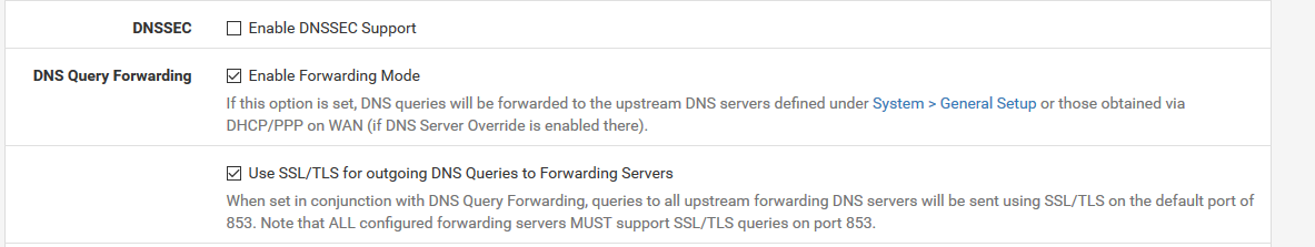

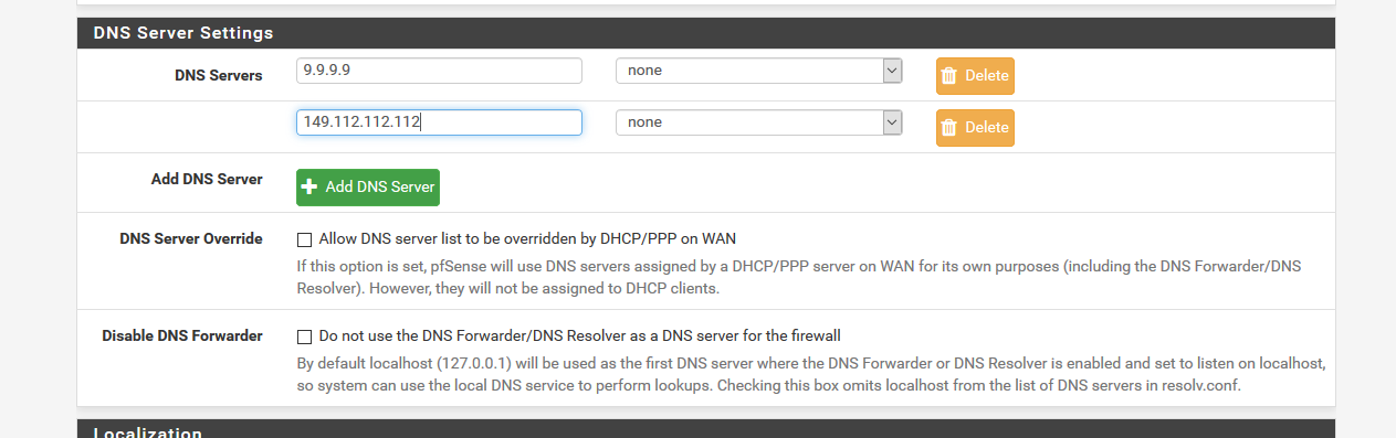

      I've attached a few screenshots of relevant settings and would love any thoughts/advice. Thanks!
      DNS Servers:
      DNS Firewall Rules:
      DNS Ports:
      DNS Resolver Settings:

                I just tried disabling DNSSEC Support while enabling DNS over TLS... rebooted PFSense just for good measure, but still seeing the same result (ie, no clients can resolve DNS through PFSense). I've never enabled TLS for local resolutions but I confirmed that was still off as well.
                When attempting to resolve via clients, through nslookup, I'm always receiving either a timeout while connecting to the DNS sever (my PFSense box) or the error:
                ** server can't find google.com: SERVFAIL

                  also from JohnPoz screen shot i unchecked Disable DNS Forwarder . so it lists 127.0.0.1 as a DNS name server. but the ping fluctuates tremendously.
