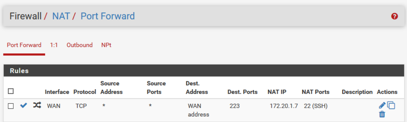

      I have a new installation of a pfsense 4.4.0. I create a NAT / Port Forward Rule as the next screenshot: 0_1546445601698_Captura de pantalla 2019-01-02 a las 17.12.26.png

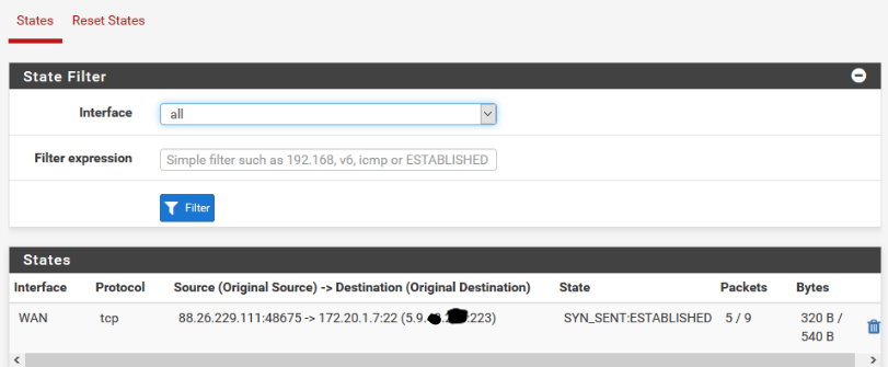

      I see traffic on this rule:

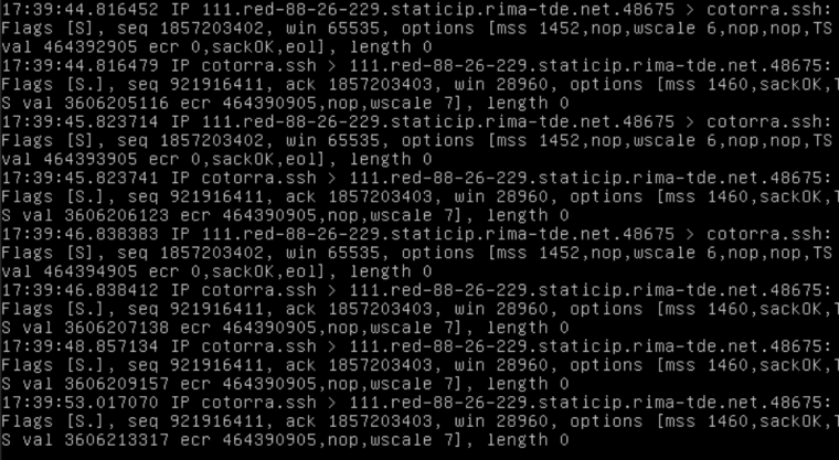

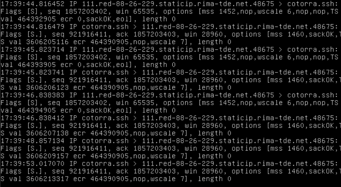

      In the remote Linux box i see this(sorry for the bad quality): 0_1546447397805_Captura de pantalla 2019-01-02 a las 17.39.58.png
