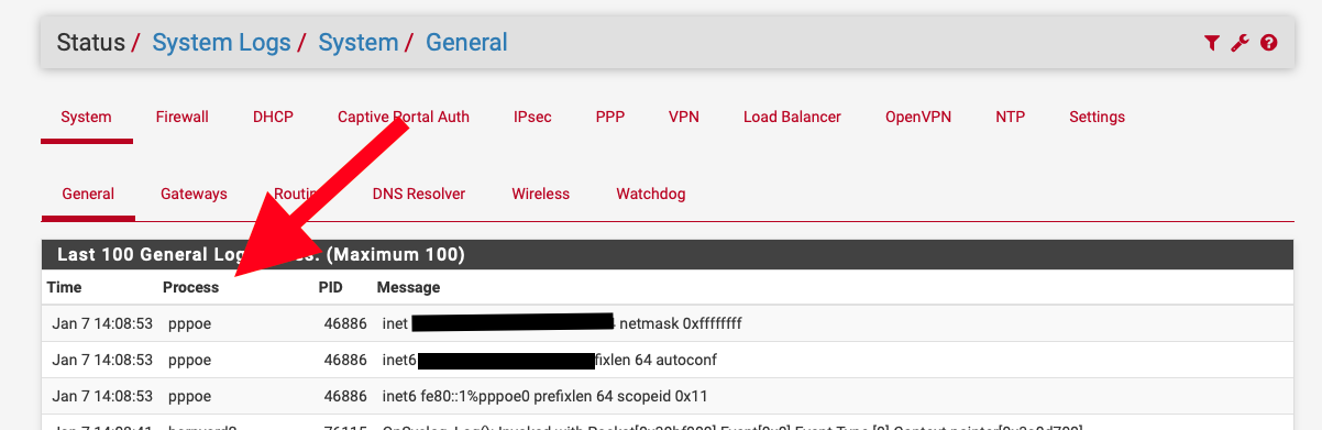

        Or set a cronjob to run ifconfig and output the config to System logs using ifconfig pppoe0 | grep inet | logger -i -t pppoe the -t could be whatever you wanted to call the process name
        Andy
          You can just filter the logs by IP change and you will see changes listed for the time covered by the logs:
          That does show all 'WAN' type connections so an OpenVPN client connection also in my case there.
