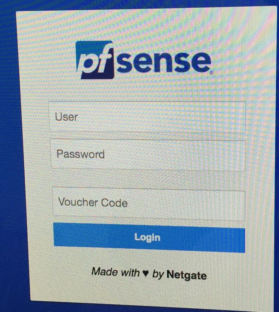

      I have pfsense 2.4.4._1 Captive portal with LDAP ( Windows 2008 AD Server ). AD server configured @ User Manager - Authentication server and it works fine while testing at Diagnostics - Authentication. Also I can authenticate Captive portal user without any issue. But the CP users can authenticate only entering the user name ! ( without entering a password ). How to fix the issue ?

          I'm using modified default login page with user, password and voucher code. unfortunately the page allows the user to authenticate with empty password ...
          	  <form name="login_form" method="post" action="http://192.168.11.1:8002/index.php?zone=srmg">		<input type="text" name="auth_user" placeholder="User" id="auth_user">
          		<input type="password" name="auth_pass" placeholder="Password" id="auth_pass">				<br  /><br  />
          				<input name="auth_voucher" type="text" placeholder="Voucher Code">
          				<input type="hidden" name="auth_pass" value="" />
          		<input name="redirurl" type="hidden" value="http://detectportal.firefox.com/success.txt">
          		<input type="submit" name="accept" class="login login-submit" value="Login" id="login" >
          	  </form>

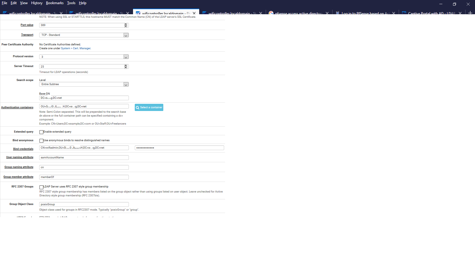

                                          I think that the problem is that the Base DN or the Search Base DN (I will try) are set as the rootDSE of the domain for which anonymous binds should be allowed by design.

                                            I have that exact same issue.
                                            Did it fix something to change the search base OU?
