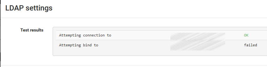

      Hi @ all,
      the new version 2.4.4_2 seems to have an issue with the ldap ssl connection and an active directory backend. I got the following output after the update from 2.4.4_1 to 2.4.4_2:
      In the system logs i see the following message:
      Jan 8 14:51:56 	php-fpm 	950 	/index.php: ERROR! Could not bind to LDAP server dc01. Please check the bind credentials.
      Without using ssl there is no issue!
      On my other cluster node, which has still version 2.4.4_1 everything works well.
      Is there anybody who has a clue whats the problem?
      If not, i might discovered a bug ...

          streetsfinest @jimp
          @jimp
          Here is the event log entry from the domaincontroller:
          unknown_ca
          Received a valid certificate chain or partial chain, but the certificate was not accepted because the CA certificate could not be located or could not be matched with a known, trusted CA. This message is always fatal.
          I have not changed any certificate or CA on the pfsense webgui. When i use the older version everything works very well.

                streetsfinest @jimp
                @jimp
                I will reimport the Root CA Chain. What about the ldap log patch which you have created:
                Is it still working with 2.4.4 ?
                I got the following error:
