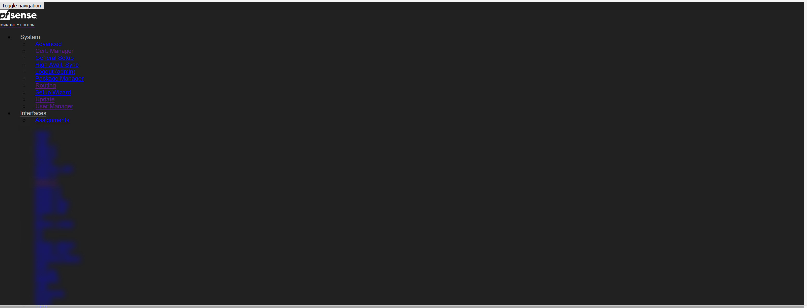

      My backup webGUI is loading very very slow and come times i have to reload the page few time to load and sometimes the page is loaded but the pfsense logo is in the whole screen the menu is like one under an other the page images are missing links are not clickable complete mess

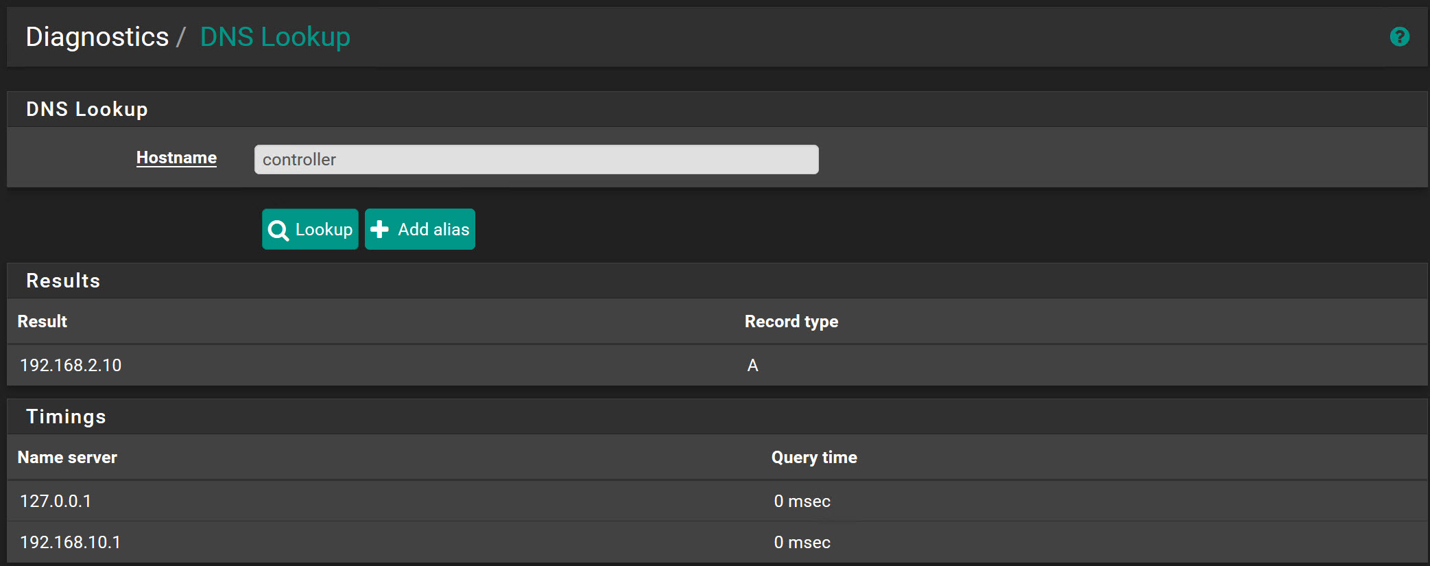

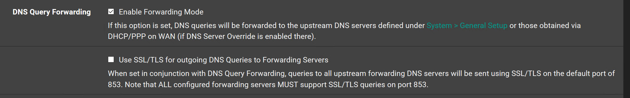

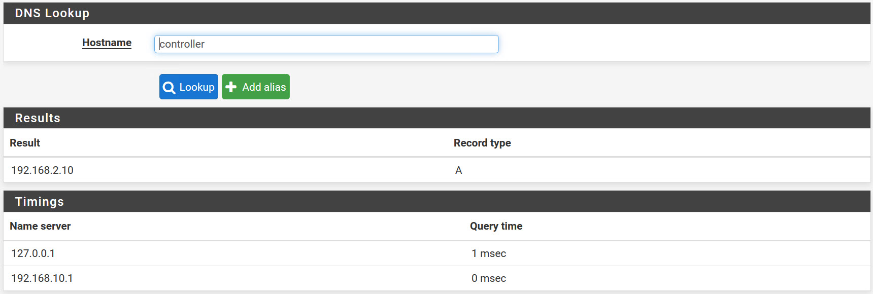

                  @derelict Master is dark theme Backup is light
                  192.168.10.1 is the upstream pfsense unbound
                  I set the downstream pfsense to forwarding mode

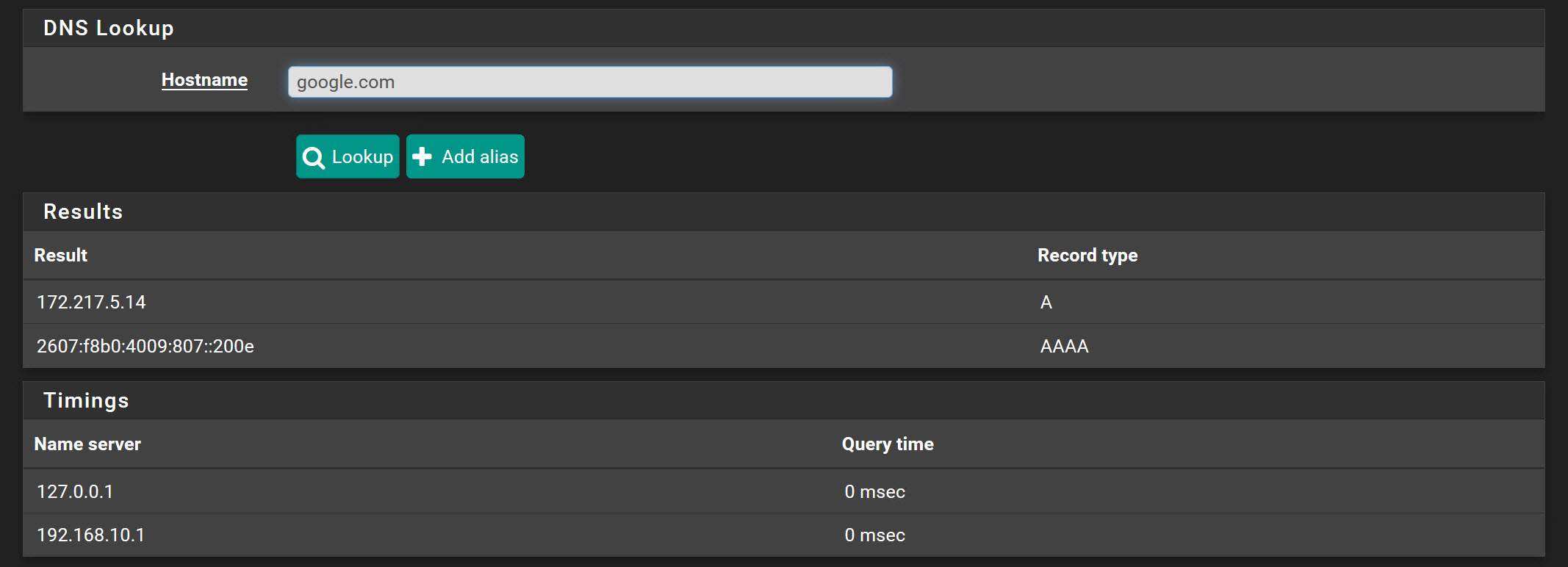

                    How about names out on the internet? Like files00.netgate.com?
                    You rattled off about 6 different problems in your initial post. What, specifically, is your priority to fix?
                    Chattanooga, Tennessee, USA
                    X 1 Reply Last reply Reply Quote 1
                    • X Offline
                      xlameee @Derelict
                      @derelict
                      both have the same output
