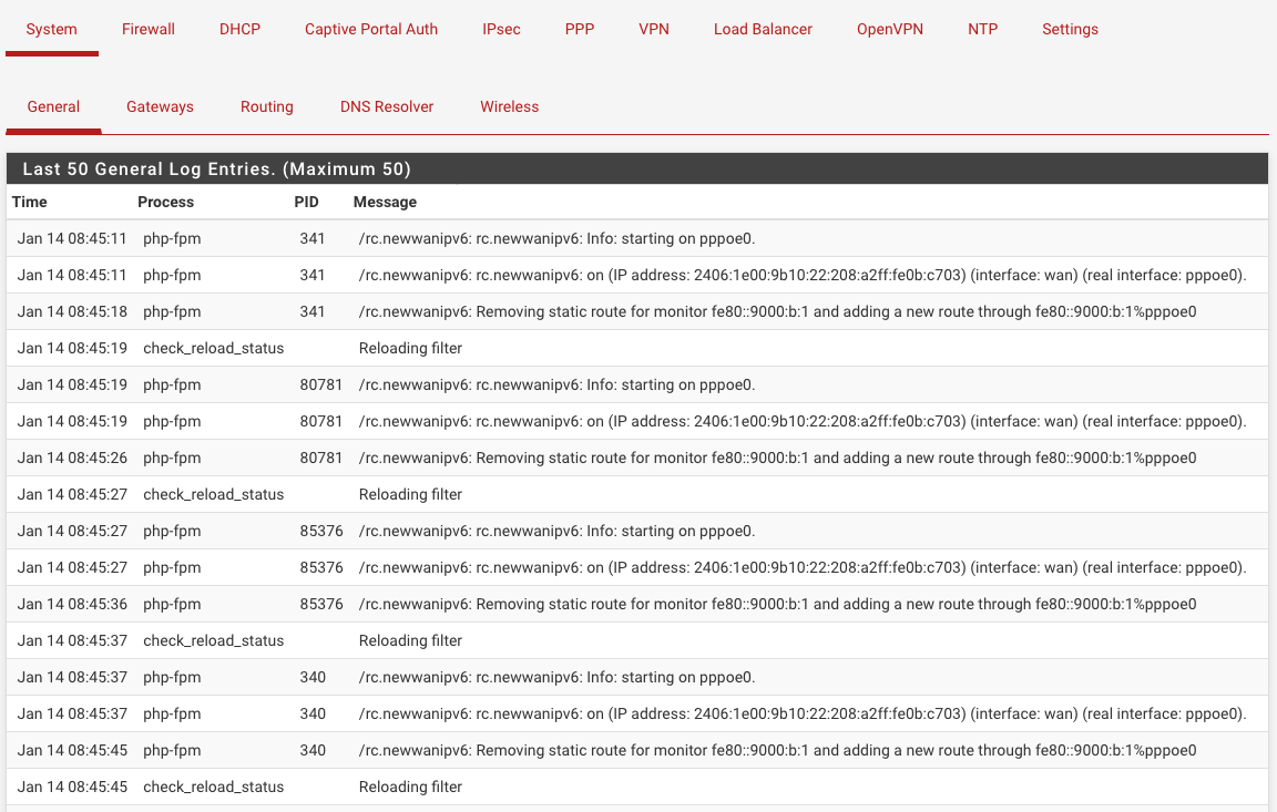

              Crash was not the right word, they continually restart. When I re-enabled IPv6 today to investigate it looks like it's because the IPv6 address keeps "changing" (although the address itself does not change):
              The DNS Resolver log shows that unbound is repeatedly starting and stopping, presumably each time the IPv6 address "changes"

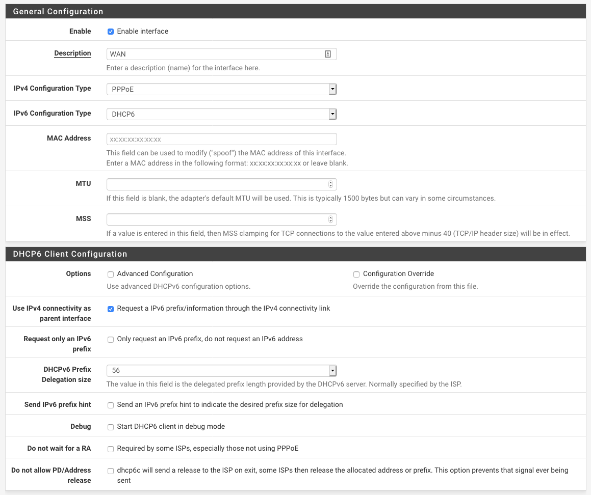

              My IPv6 settings at the moment are:
              WAN Interface:
              (I have also tried with "Do not allow PD/Address release" enabled)

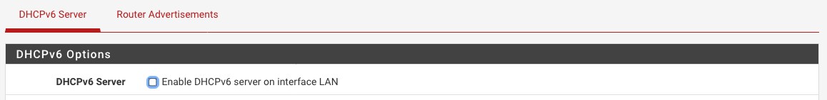

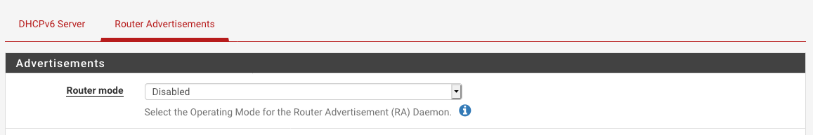

              DHCPv6 Server:

                  @jknott Yes, I currently have "Do not allow PD/Address release" enabled and the following is still being repeatedly logged:
                  Jan 14 12:05:26 	php-fpm 	12023 	/rc.newwanipv6: Removing static route for monitor fe80::9000:b:1 and adding a new route through fe80::9000:b:1%pppoe0
                  Jan 14 12:05:27 	check_reload_status 		Reloading filter
                  Jan 14 12:05:27 	php-fpm 	12023 	/rc.newwanipv6: rc.newwanipv6: Info: starting on pppoe0.
                  Jan 14 12:05:27 	php-fpm 	12023 	/rc.newwanipv6: rc.newwanipv6: on (IP address: 2406:1e00:9b10:22:208:a2ff:fe0b:c703) (interface: wan) (real interface: pppoe0).
                  I turned gateway monitoring off for the default IPv6 gateway and the first line is no longer logged, but the remaining lines are. The logs don't seem to indicate why rc.newwanipv6 is being triggered every 10 sec or so.
