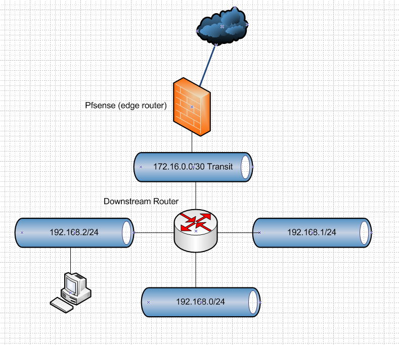

              Static routes? No that is not what a transit network is..
              You have a downstream router.. With networks hanging off of it... The default route for clients is always the downstream routers SVI in their vlan.
              The downstream router talks to pfsense via on different network, there are no hosts on this network... Its a transit network from 1 router to another router.. Or it could be the network that connects multiple routers together...
              The only default route the downstream router has is pfsense.. In knows how to get to all the other local networks since they are directly attached.
              So again lets ask - why do you need more than 1 network? You have a handful of devices? Saturating the link to the internet? Yeah in your current setup where your pfsense is routing traffic between vlans your local traffic could be a problem for internet traffic since they share the same path. But if your devices are all on the same L2.. The only traffic going to pfsense IP would be internet bound traffic - host A talking to B would only be over their switch ports..
              And you remove the need for downstream router, etc.
