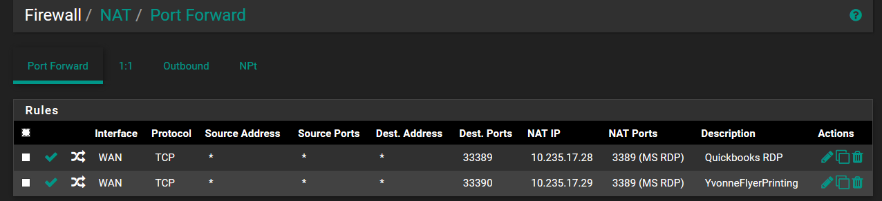

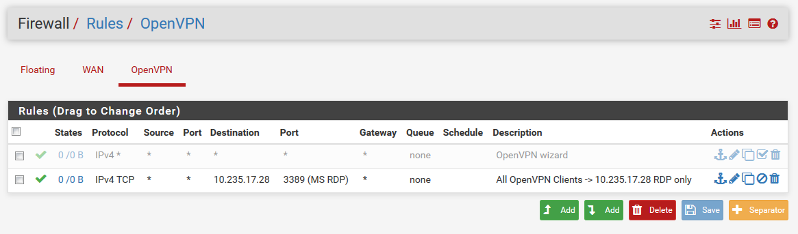

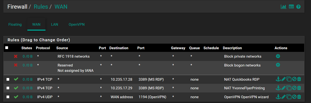

          So in order for a remote IP to come through and go directly to a target resource I must set that up in the Firewall Rules such as has been done by the previous network admin before I took over as shown below...I am trying to get IP .28 and .29 off of MS RDP and onto OpenVPN for security.
          It appears that the OpenVPN rule was set by default when I completed the configuration.
          Must I add the info in the Firewall NAT for the external client get to LAN IP 10.235.17.28 after entering through our WAN gateway for example?

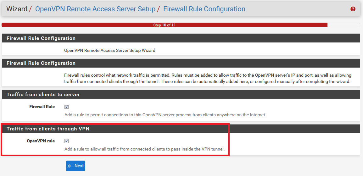

            To let traffic flow inside the OpenVPN network you need to add Firewall Rules in your Firewall -> OpenVPN tab
            When you run the OpenVPN Wizard in the last step there is one checkbox, then the wizard will add some any-any Rule for you:

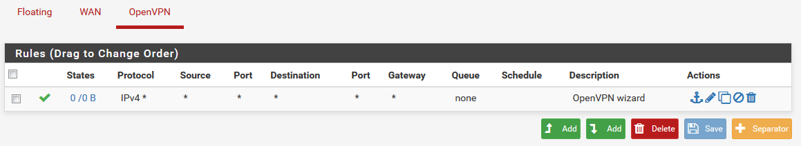

            This will create:
            For security reasons, if you want only RDP to one server from all clients you can narrow this down:

              The firewall NAT and rules are in place for OpenVPN and I do not think that is the problem.
