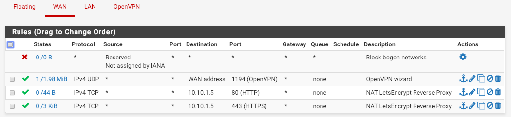

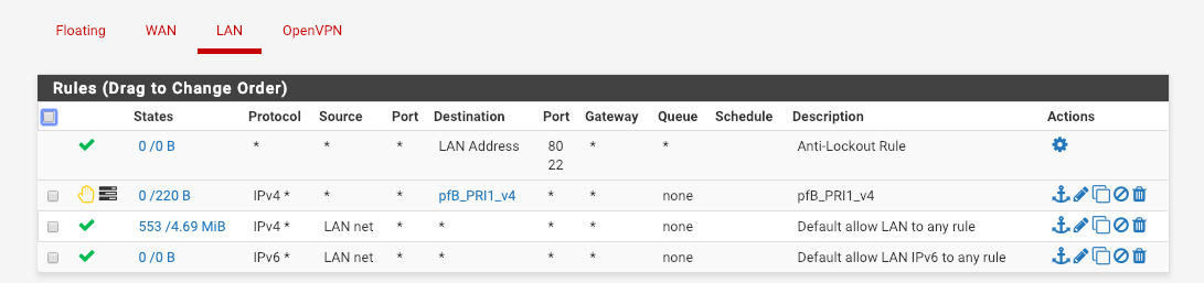

      Hi. Ive got pfSense on ESXi VM running on a construction site - so the whole system - ESXi machine, switches, cable modem, etc is often switched on and off at same time from a fuse board.
      Sometimes when the power is switched on, everything works out of the box, but on average every second time the system starts, im getting no routing between WAN and LAN/OVPN interfaces in pfSense. PfSense gets a correct ip addresses from DHCP server, i can ping from WAN interface in pfSense, i can even VPN to pfSense network from outside location, but there's no outbound traffic from internal network to the Internet. Usually it can be fixed by restarting pfSense and/or ESXi a couple of times. Anyone can advise how to troubleshoot this?

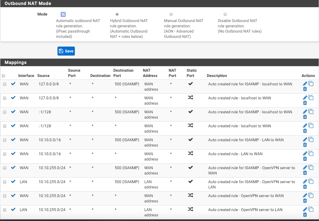

        Why is your outbound nat in Hybrid? And why do you have outbound nat for your LAN address?
          dinth
          I believe that all those rules were auto generated when I was setting up pfSense.
          I changed from automatic to hybrid when I was setting up OVPN and assumed that i will need hybrid if additional Nat rules are added

            Well you have NO added rules... And NO you should not have outbound nat rules on your LAN... Did you set a gateway on your lan interface??? Which it tells you like 100 times during setup not to do..

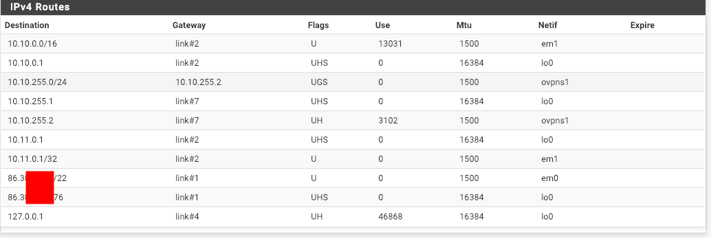

            Why do you have 10.11.0.1/32 on your em1? And you understand your tunnel network is overlapping with that pfblocker vip which created a route for 10.10/16 out em1??
            Yeah you have a gateway set on your lan this 10.10.255.2??? Why would you set that? Its no longer a lan network when you do that but another wan interface..
              That's something pfBlockerNG automatically set up. 10.11.0.1 is the virtual IP address it uses (i have chosen it, because documentation says that vIP should be outside of the ip range which is 10.10.x.x for me)
              10.10.255.x is range for OVPN clients, 10.10.255.2 was probably my machine when i've been making those screenshots.

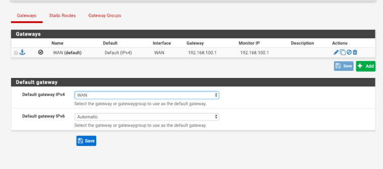

                  It looks like you have no default route. I would resave the WAN as your default gateway and recheck the routing table to make sure a default route is present.
