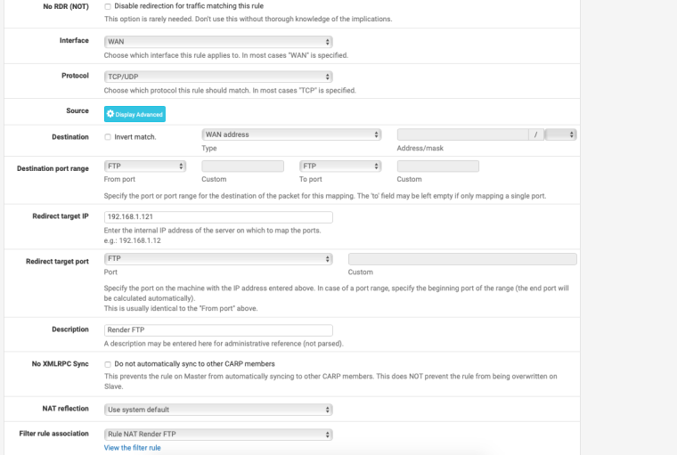

      Having some issues forwarding Port 21. Not sure if I've missed something obvious or whether it is our ISP. Any suggestions would be appreciated.

                                  When I compare my port forward with the images you atatched I see a couple differences
                                  1. On port forward page I have WAN address instead of WAN net as Destination
                                  2. On the FW rule page I have any instead of WAN net as Source
                                    Source of wan net would only allow IP from the wan net, ie the transit network that connects you to your ISP.. that is NOT the internet.
                                    Also dest should be your wan address...
                                      roryahanan @no_jah
                                      @no_jah I did in fact make these changes previously and didn't update the reference photos so these are the updated photos
                                      0_1548853276259_Screenshot 2019-01-30 at 12.59.57.png 0_1548853280597_Screenshot 2019-01-30 at 13.00.15.png
