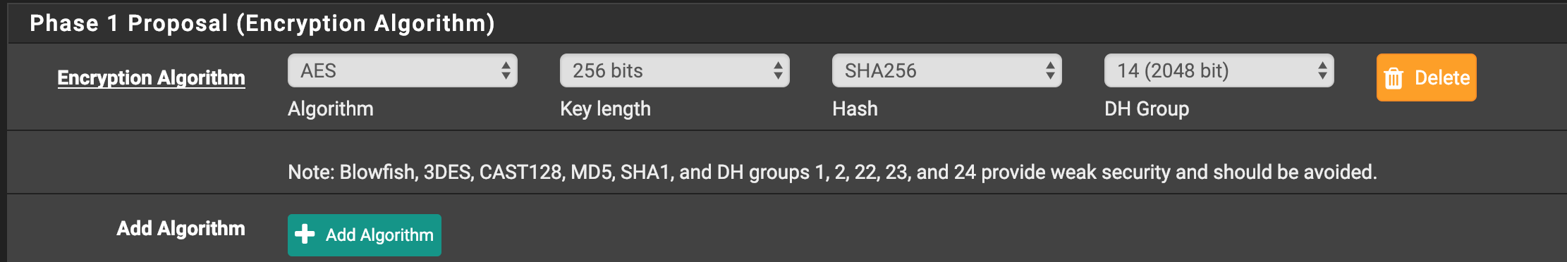

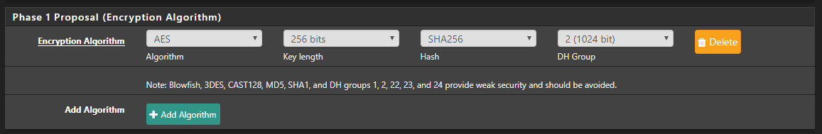

          Here is the Phase 1 on the pfsense side
