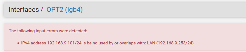

          So your trying to give pfsense interfaces 4 IPs in the same range? Yeah I don't think that is a supported scenario.
          Sure isn't via setting them static. So why should it work via dhcp?

              Yeah that is not a supported scenario from my understanding. You can not put multiple interfaces in the same network.. If you want to use multiple IPs in the same network you would use a VIP setup.
              Try creating a static IP for another interface where the IP you set is in the same network as another network and it will scream at you.
              So I don't see why assigning the IP via dhcp would work either.

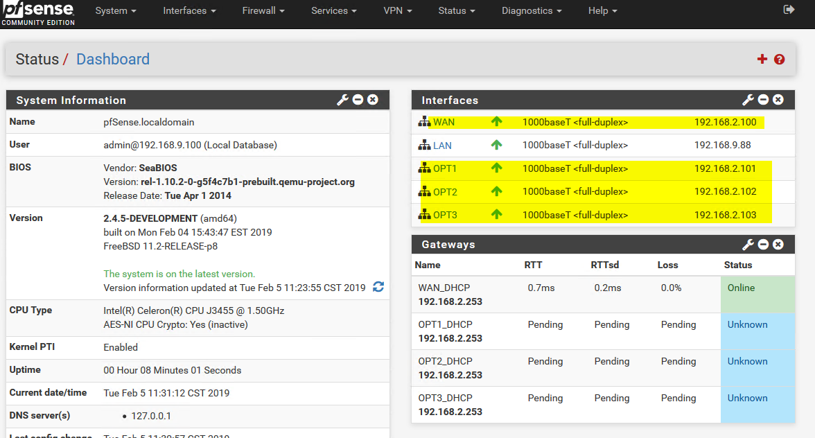

                  edit: When i get a chance I will duplicate such a setup on my VM pfsense.
                  edit2: Ok I fired this up on a pfsense Vm, added some more interfaces set to dhcp - setup some reservations for their macs, and boom they getting IPs no issues.
                  If I had to guess its problem with your ISP handing you your lease - simple enough to validate with a sniff.
                  Whats your dhcp log say... I see it asking for and getting the IPs
                  Here is the log from one of them for example
