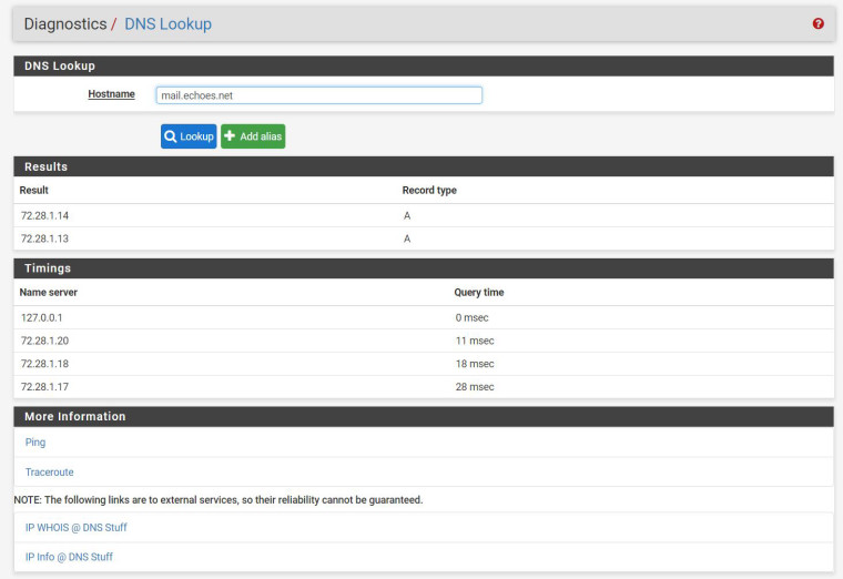

                      Port 993 is encrypted IMAP.. If you did did not change the default lan rules any any is allowed. And prob just a DNS problem.. Go to pfsense dns lookup does that resolve? Can you please post the output of this screen
                      • I Offline
                        itstheburns
                        Same for me.
                        It works just fine outside of my network with pfsense. It works just fine if I connect my old router.
                        I got it working. I added 8.8.8.8 and 8.8.4.4. I kept glossing over this page for some reason and missed DNS Servers.
                        I don't know why they have their dns setup the way it is and I don't know why it works fine with my asus router but its working now. If theres a better or different way, I'm open to learning how to do it.
