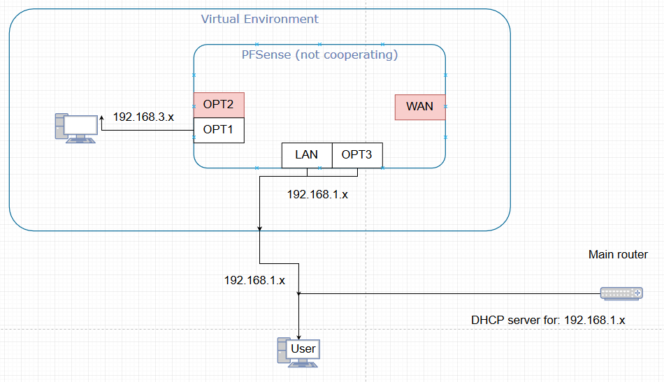

      I'm running a PFSense box with 5 ports (WAN, LAN, OPT 1-3) in a virtual environment (VirtualBox) as shown below:
      Currently I have the LAN & OPT3 attached to a bridged connection so that I can access the webgui from outside the virtual environment (it seems only the LAN port works for accessing the webgui). I also have OPT1 on a separate isolated connection (VirtualBox calls in an intnet). All other ports are on their own isolated intnets, and not connected to anything.

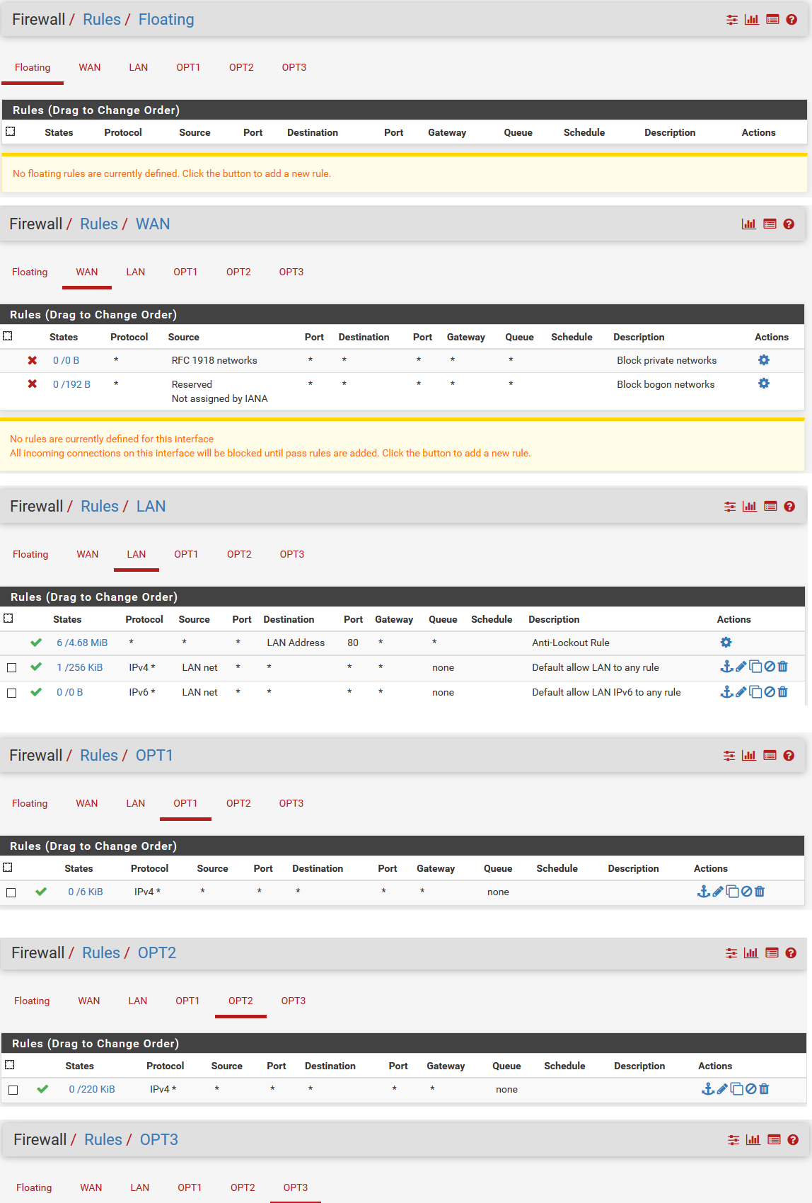

      I've seen a few related questions that indicate firewalls may be an issue, so I've taken the liberty of attaching my firewalls rules below. I do not think they are the problem, but I'd be happy if they were--easy fix!
