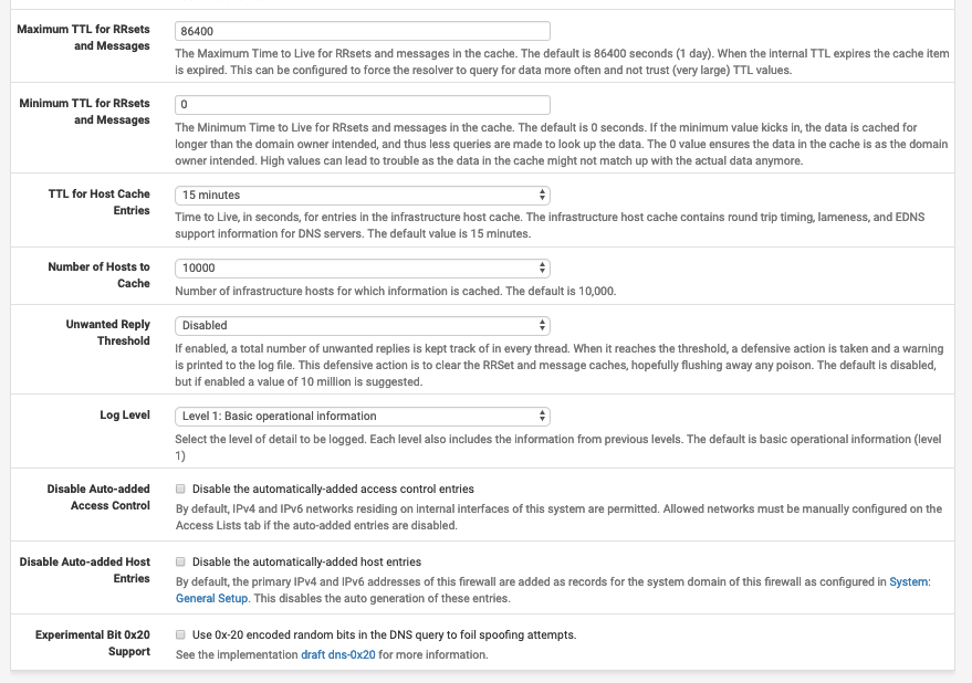

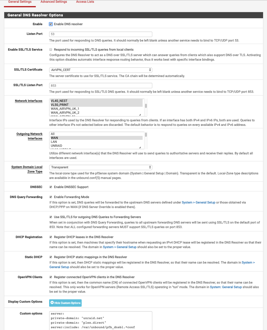

              Here are the config screenshots:

                are you following a guide for this? it looks like youre using the AirVPN cert on this DNS instance.
                asv345hA 1 Reply Last reply Reply Quote 0
                • asv345hA Offline
                  asv345h @isolatedvirus
                  This config came about form a few sources, blogs/youtube/pfSense docs/hangouts, and my own understanding of how it should work.
                  I thought that setting was only used if "Enable SSL/TLS Service" was set, so that clients can query unbound over TLS, which I'm not doing.
