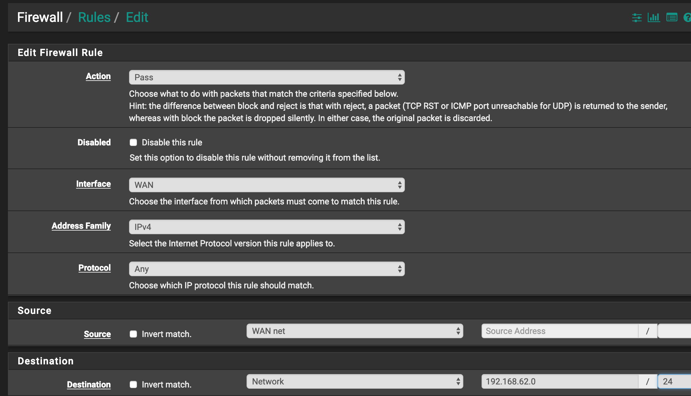

                    1.From windows cli
                    route add 192.168.62.0 mask 255.255.255.0 10.0.0.7
                    2 Create an allow rule for the network 192.168 on the WAN interface 10.0.0.7

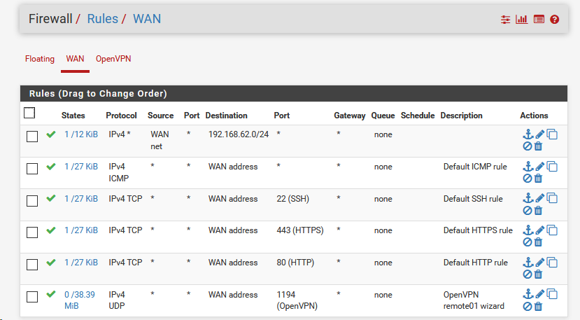

                              1. 10.0.0.7 already knows about this network
                              No need to create another static route on 10.0.0.7 for network 192.168.62.0 / 24
                              Don't need to configure OUTBOUND NAT now
                              Need to, for example
                              1. on host 10.0.0.4, run the route add command ( see previous post)
                              2. create allow rule (see previous post)
                              Then you can ping the host 10.0.0.4 from the network 192.168.62.0/24
                              and the host 10.0.0.4 will be able to ping the network 192.168.62.0/24
                              https://forum.netgate.com/topic/140925/site-to-site-cannot-ping-from-one-lan-to-other-lan/17
                                A Former User
                                thanks but i added the firewall rule in openvpn client and the route add 192.168.62.0 mask 255.255.255.0 10.0.0.7 on 10.0.0.4

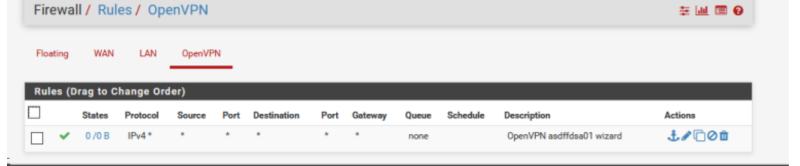

                                  Check to see if the numbers appear in this place ?
                                  This is a rule on the OpenVpn server interface
                                  Can host 10.0.0.4 ping 192.168.62.1 ?
                                  Can host 192.168.62.1 ping 10.0.0.4 ?
