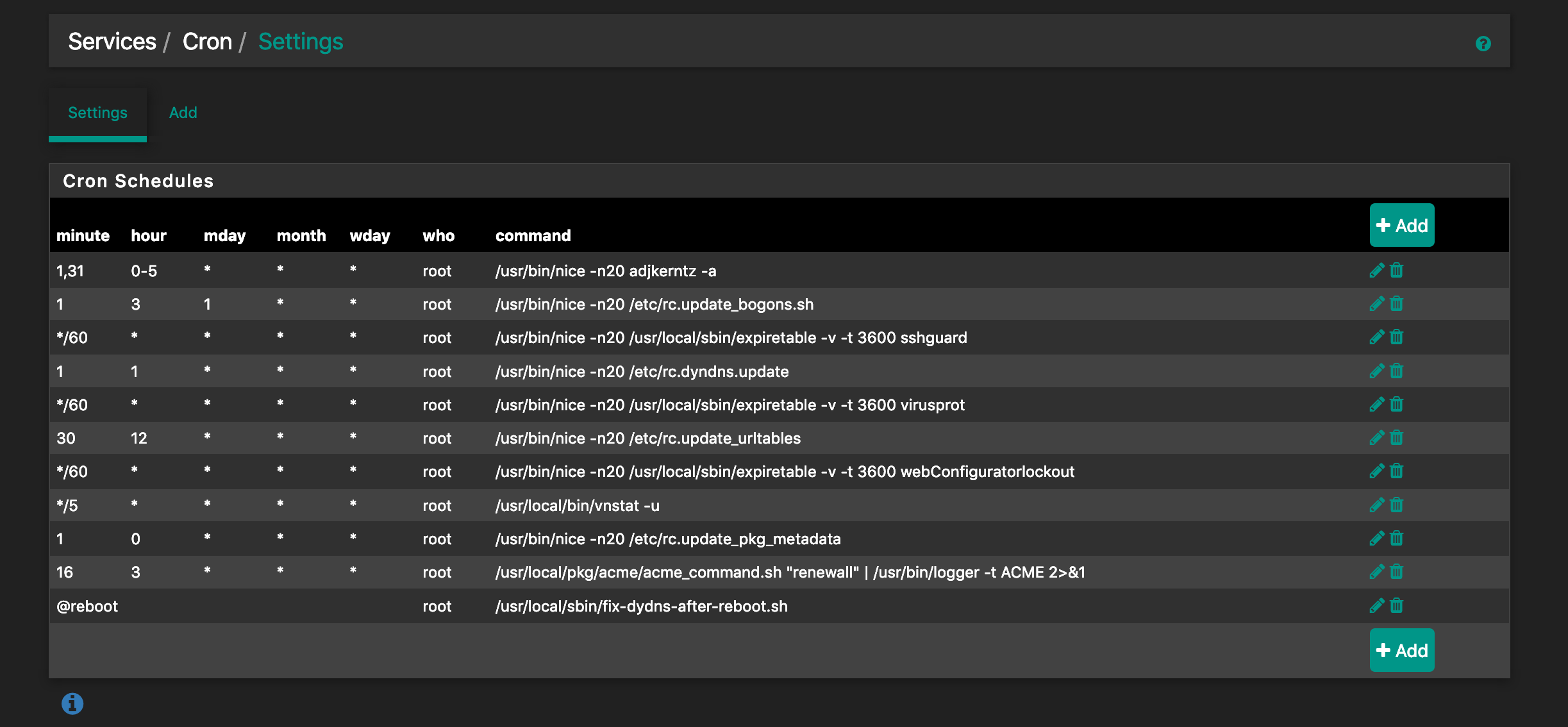

                                    dvl
                                    Confirmed, this worked, by viewing: /status_logs.php
                                    I then added to cron, to run at a soon-to-occur time. That ran fine too.
                                    I am now confident this will run at @reboot.

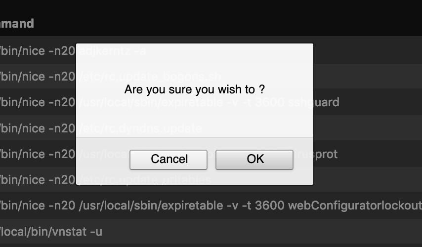

                                      An interesting popup when trying to delete a cron entry:

                                        dvl
                                        This is what the resulting cronjob looks like:
