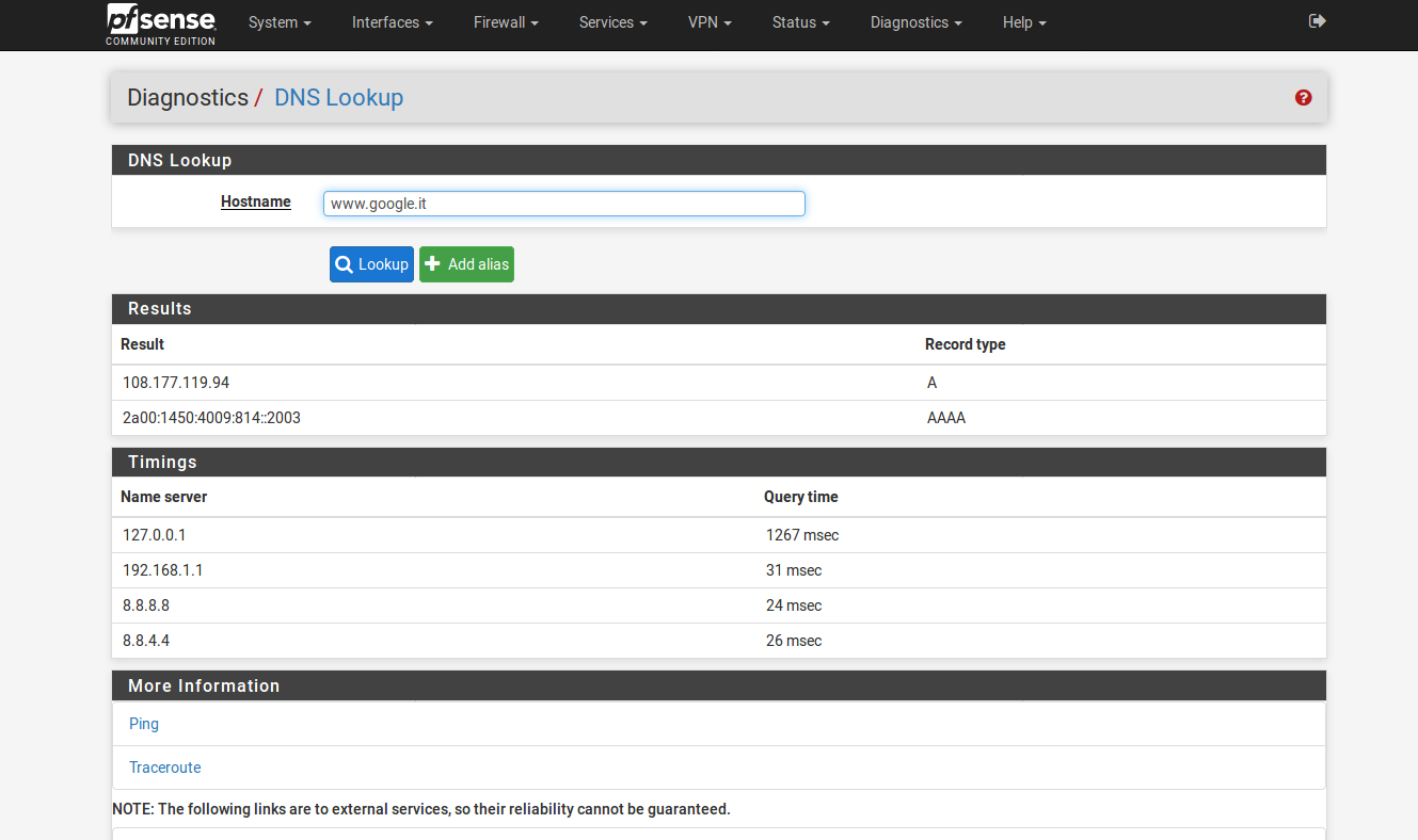

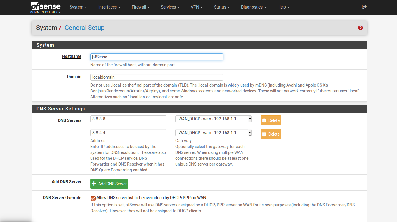

            I made a clean new installation, but the result does not change. I think I did everything you told me ... I'm almost giving up
            2_1551192516314_Cattura2.PNG 1_1551192516313_Cattura1.PNG 0_1551192516313_Cattura.PNG

              In your General Setup screen, I don't think you need the gateways defined for those 2 Google DNS servers. Of the 5-6 pfsense boxes I've installed and managed, I never have to put in a value there.
              Set those values to "None", save your settings, maybe even reboot the pfsense instance, then try the internet from your LAN network again...

                Agree with that.
                One shouldn't even touch anything related to DNS the first 48 hours after initial setup.
                No where it has been said in any firewall setup-doc that a DNS should be set ! Not in the official Netgate support doc, and no where else.
                These "8.8.8.8" and "4.4.4.4" are like "Christmas" and "Antivirus" : they were invented for pure commercial reasons.
                (IMHO)
