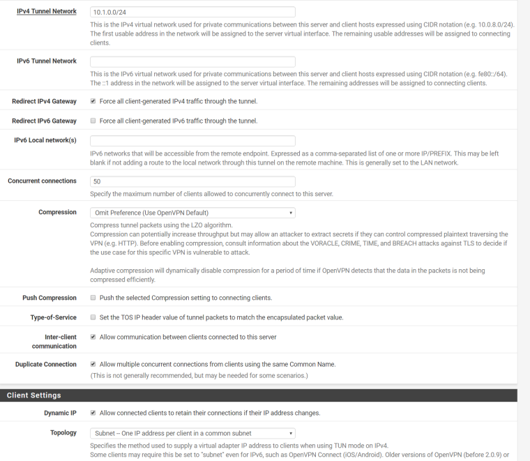

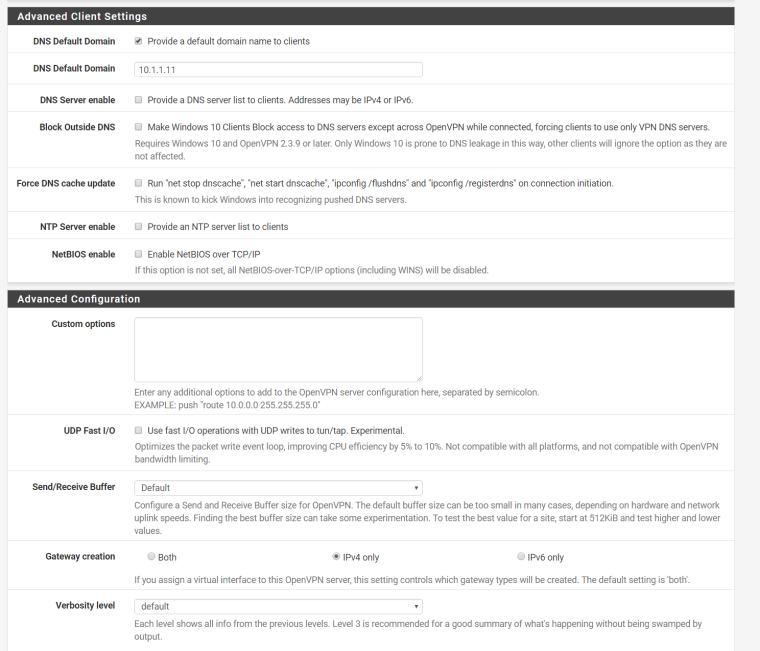

          Share your OpenVPN settings and Firewall Rules (screenshots).
          -Rico

              Cannot be from Firewall, first user working ok.
