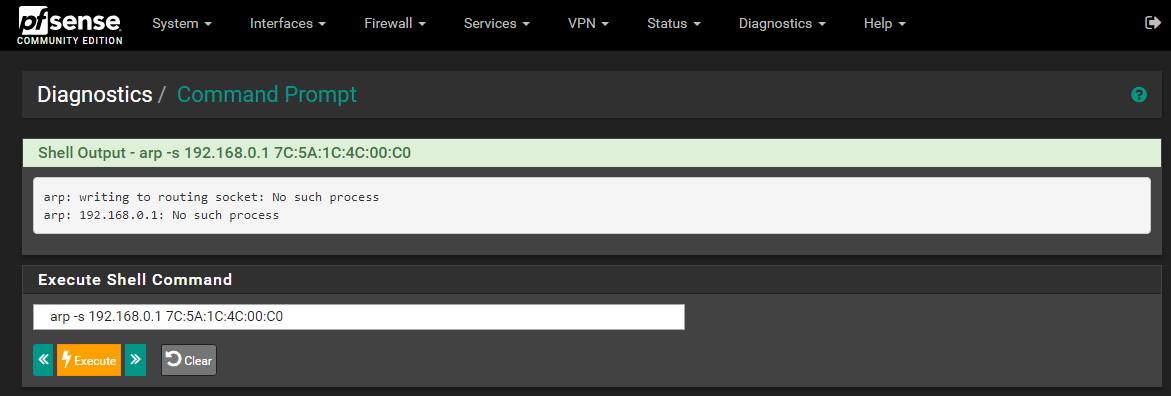

      Hello, I have been trying to figure out how to set a static Arp entry for the gateway that my pfSense router connects to (WAN GW).
      The reason I am wanting to do this is because I am currently living in a dormitory while at college and have been wanting to use pfSense over here in place of my current DD-WRT router. The problem is that the dorm network is 192.168.0.0/16 which is basically what every other home router on the market is defaulted to (192.168.0.0/24 but you get my point).
      The problem is that there is another router that has been plugged in incorrectly on this network which causes havoc in terms of two devices having the default gateway IP address, one is the real one and the other is not. How I got around this was by using the command "arp -s 192.168.0.1 7C:5A:1C:4C:00:C0" on my DD-WRT router so it would always connect to the right gateway and not the fake one that doesn't work.
      I have tried looking at many different forum articles but they all seem to revolve around the LAN and the DHCP server which is not applicable in this case. I then tried following some FreeBSD guides about setting a static Arp entry but then found out that many of those files are not in use on pfSense. Any help would be greatly appreciated as I love using pfSense at home and would like to do the same while I am at college.
      Thanks

        But that aside. The only real facility for doing that in pfSense is via the DHCP static leases which obviously doesn't apply here.
        I assume that if you run arp -S 192.168.0.1 7C:5A:1C:4C:00:C0 at the command line it works and the gateway is then seen as a permenant entry in the ARP table?
        You can run that command at each boot using a shellcmd:
        https://docs.netgate.com/pfsense/en/latest/development/executing-commands-at-boot-time.html
        The only issue you might have is if you disconnect the WAN without rebooting it may lose the static entry.
            That is the command that I can run on DD-WRT and will work. Unfortunately when I try to run that command on pfSense, it returns the errors shown below. Is there a command equivalent to "arp -S 192.168.0.1 7C:5A:1C:4C:00:C0" for pfSense?

              Hmm, that IP is in the ARP table?
              Most common cause of that error appears to be a subnet mismatch somewhere.

                While you can for sure add a static arp entry to pfsense.. That is NOT the correct fix here... The correct fix would be to track down the offender and remove the device from the network.. Or have them use a valid IP ;)
                I would then have your IT guys look into something as simple and free as packetfense ;)
                If the IP is already in your arp table you would need to clear it before adding a static..
                Lets see the bad arp entry..
                arp -a
                Curious the mac of this bad device - we should atleast be able to figure out what make of device it is from the first part of the mac.
                  If said bad device is connected wrong you can probably just connect to it and see exactly what it is.
                      I am aware that setting a static ARP entry is not the correct solution. However, as previously alluded, the IT department here is full of idiots and is not worth the time to talk to about the issue because they will simply ignore you. Other students and myself have tried and it leads nowhere.
                      What I would like to know is what command or page do I need to use to set a static ARP entry (that does not reside within my LAN and is not associated with my DHCP server)? I like pfSense but I would still consider myself a noob with it so you may have to explain in more detail (it doesn't help that is is built off FreeBSD as I am more accustom to Debian).
                        You need to delete the bad entry then add a good entry with your arp command..
                        Use the big S vs the little s
                        Here I just overwrote my printers arp entry with mac of your Bad Guy.
                        [2.4.4-RELEASE][root@sg4860.local.lan]/root: arp -a | grep 192.168.2.50
                        BRN30055C116AD9.local (192.168.2.50) at 30:05:5c:11:6a:d9 on igb2 expires in 1023 seconds [ethernet]
                        [2.4.4-RELEASE][root@sg4860.local.lan]/root: arp -S 192.168.2.50 08:02:8E:7A:13:52
                        192.168.2.50 (192.168.2.50) deleted
                        BRN30055C116AD9.local (192.168.2.50) at 08:02:8e:7a:13:52 on igb2 permanent [ethernet]

                        Oh you did you -S, Ah!!! your not root your admin... You would need to be root on your pfsense to do that command.. Why does your cmd line say admin vs root? If you ssh in with admin you get root..
                        Odd... But lets see your ifconfig... You shouldn't be getting that error if your actually connected to that 192.168 network.
                        See just tried creating arp entry for network not attached too.
                        [2.4.4-RELEASE][root@sg4860.local.lan]/root: arp -S 192.168.20.50 08:02:8E:7A:13:52
                        arp: writing to routing socket: No such file or directory
                        arp: cannot intuit interface index and type for 192.168.20.50
                        I don't have a 192.168.20 network.
                        Also what version of pfsense are you on - you should be getting the same error, etc. it says are you 2.4.4p2? Not sure why yours would not given you the exact info like mine did about non network and sad something about process..
                        If you ssh in as admin you get root prompt as well - so why/how are you seeing admin prompt?
                          Mmm, I tested that as admin before and it works OK. And still works for me:
                          [2.4.5-DEVELOPMENT][admin@2220.stevew.lan]/root: arp -S 172.21.16.48 30:05:5c:11:6a:d9
                          172.21.16.48 (172.21.16.48) deleted
                          The error you're seeing seemed mostly due to a subnet mash error on an interface. Can we see the output of ifconfig -a ?

                                  Hmm, not sure exactly what happened but I was able to run the arp command and this time it took.
                                  As of now I am typing this using my pfSense box for my connection to this forum. At this point what I am going to attempt to do now is configure that ARP command to automatically run at boot.
