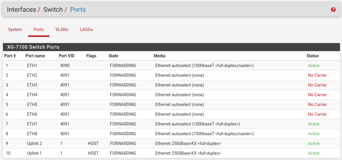

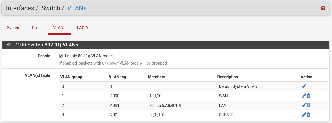

          Regarding the port/switch configuration ...
          and ...
          On ETH7 we have the "rest of the LAN" and on ETH8 we have an Ubiquiti access point which has the normal LAN on VLAN 4091 but a guest network on VLAN 200 (therefore VLAN 200 is tagged on ETH8).
          So, actually I'm still unsure of whether I have to do some additional configuration if I want devices in VLAN 4090 on ETH8 to ping6 devices in VLAN 4090 on ETH7 (or vice versa).

              I have the Unifi access point sitting behind ETH8, the Unifi Controller is behind ETH7. Using IPv4 they can talk to each other just fine (i.e. I can ping from the access point to the controller and vice versa). Using IPv6 however, I cannot reach one from the other. All other machines behind ETH7 however can ping6 each other fine as well (including the controller host). The access point has IPv6 configured as well and the interface is up and has its fe80 address assigned, and ping6 on the access point to its own fe80 address works.
              Therefore I concluded that the only thing that does not work, is IPv6 across the Netgate's switch between ETH7 <-> ETH8.
