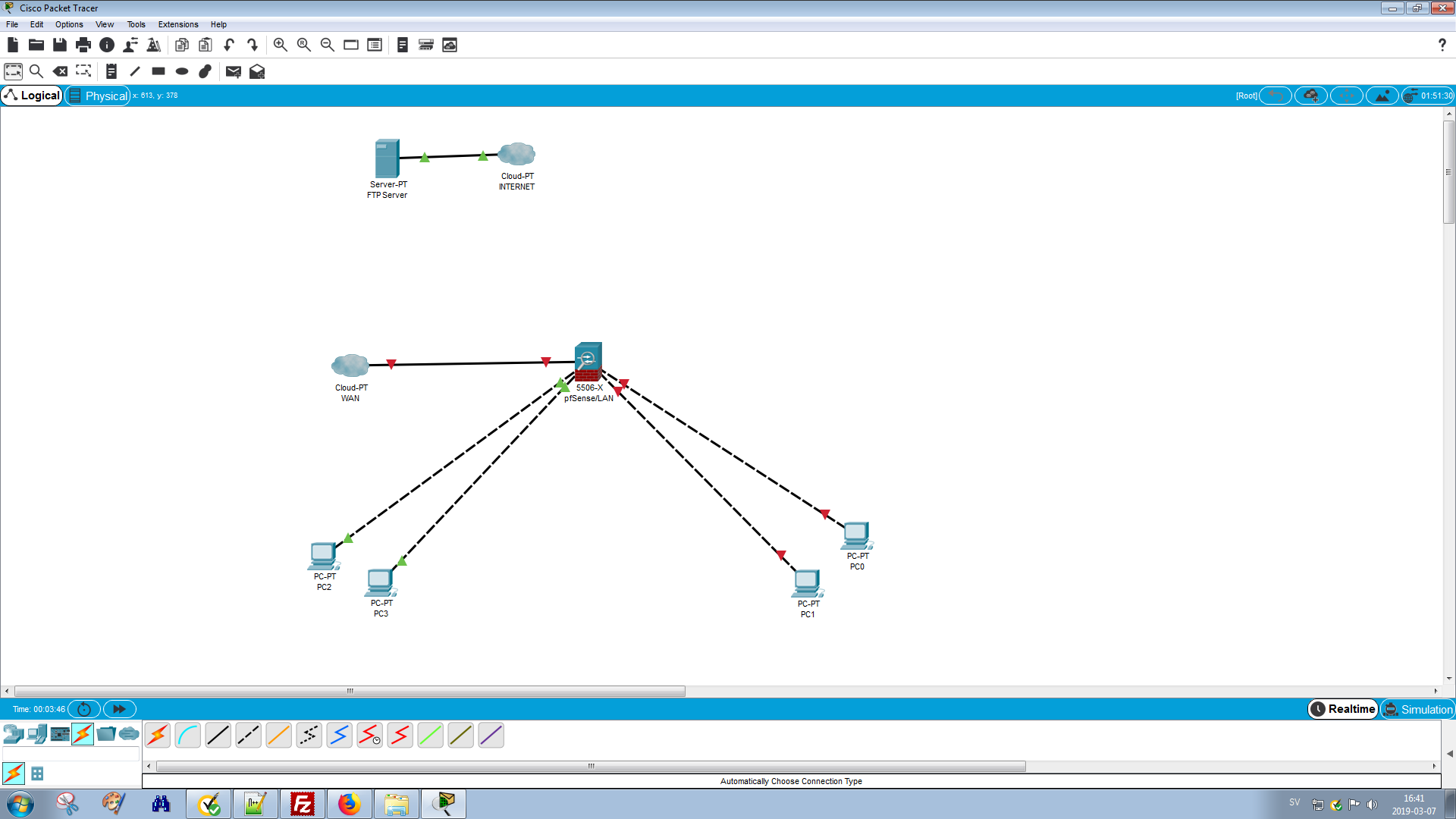

              @akuma1x It is not on my network. Think linke this, you got a FTP server in your company in Europe, but you work from home in the US, and you have pfSense protecting your home network, but you want to access the FTP server in Europe. (It is not the best example hehe) But anyways here is a scetch I made. Lets say I'm at PC2 and want access to the FTP server.
              Tank you for your time!

                So you're just the FTP client? This should work without any problem if they have their end configured properly. There is nothing you can do on your end. FTP_Client_Proxy is not required for you to use FTP client software behind pfSense ecept under certain circumstances.
                What is the actual problem you are seeing? Any error messages? I think you managed to confuse everyone and we all thought you were on the server end, trying to NAT them out to WAN.
