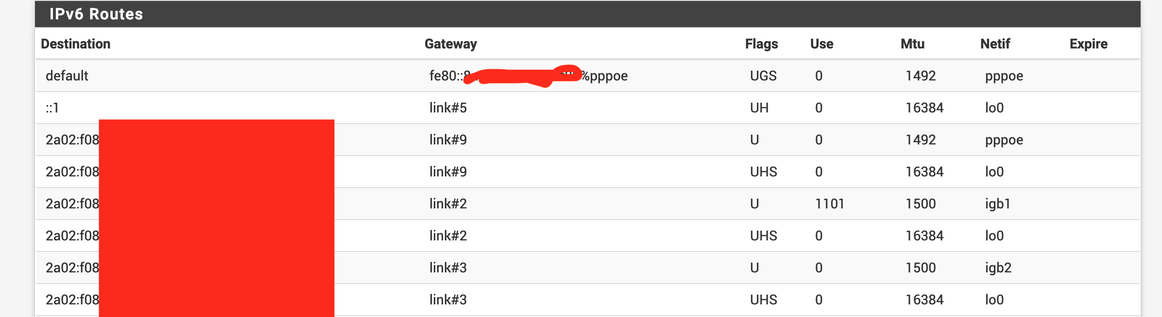

      Problem
      When connecting to my ISP, the connection setup is successfully.
      I'm getting my IPv4 + IPv6 addresses, an IPv6 prefix and everything works fine.
      I can ping remote hosts and have a IPv6 default route.

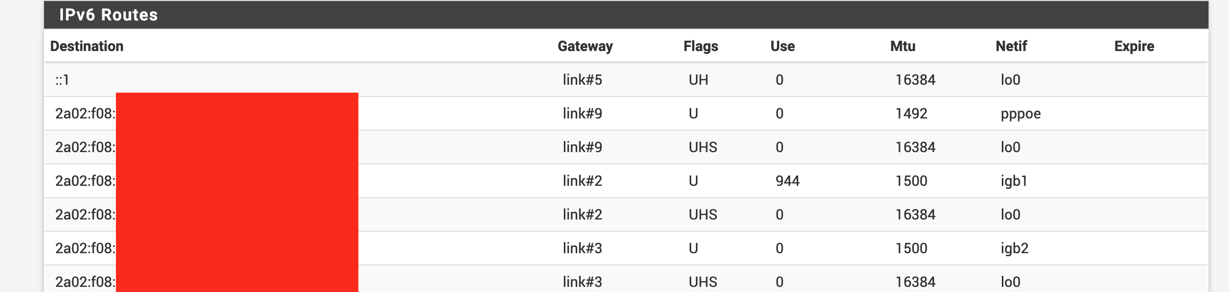

      But after some time, my IPv6 default route is gone and I'm no longer able to connect to remote hosts via IPv6.
      The IPv6 default gateway is still listed and pingable via IPv6.
      If I open the IPv6 gateway settings and save them without changing any values, the IPv6 default route re-appears and IPv6 works (again).

      No default route:
      Default gateway still listed:
      After opening the default gateway settings and saving them, without modifying anything, the default route reappears.
      Any clue? :)

              And now the most confusing part:
              When opening the gateway settings and saving them, the default route for IPv6 is back.
              But the router hasn't sent any IPv6 packets.
              Help needed! :)
