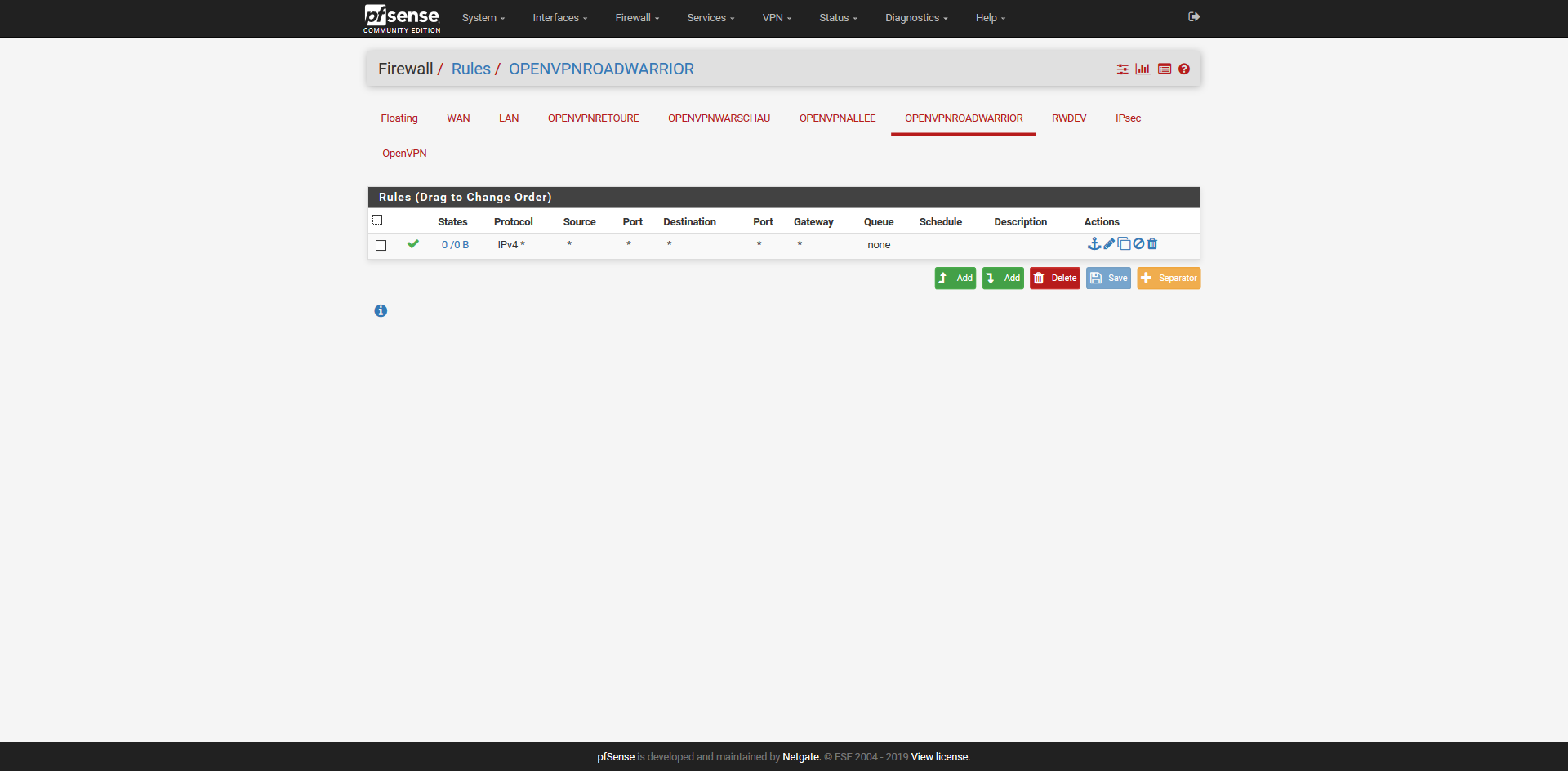

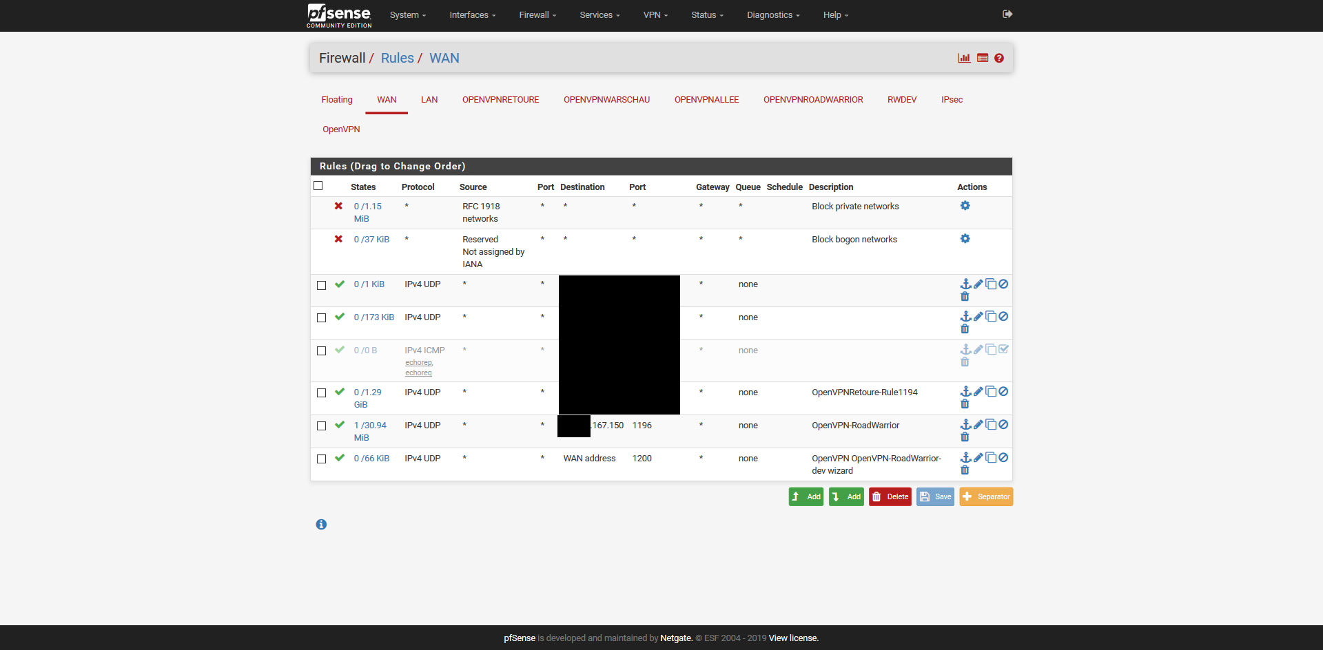

        Show your OpenVPN settings and Firewall Rules (screenshots).

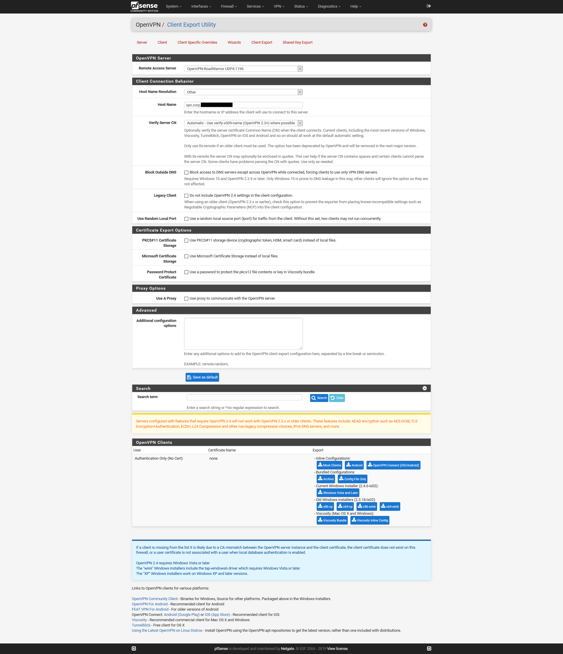

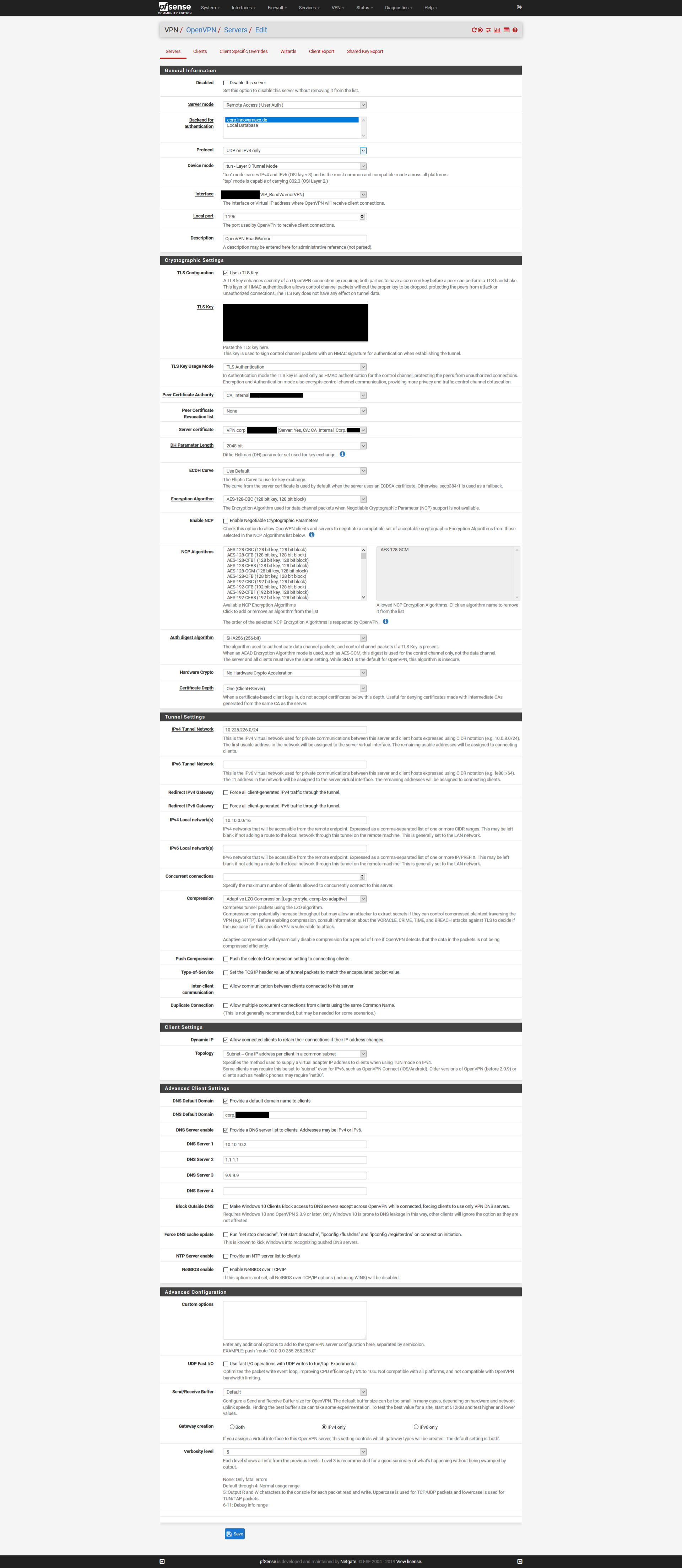

          m4x116
          hey Rico,
          here are the screenshots
          thank you for your time :)
          • RicoR Offline
            Rico LAYER 8 Rebel Alliance
            Looks OK to me.
