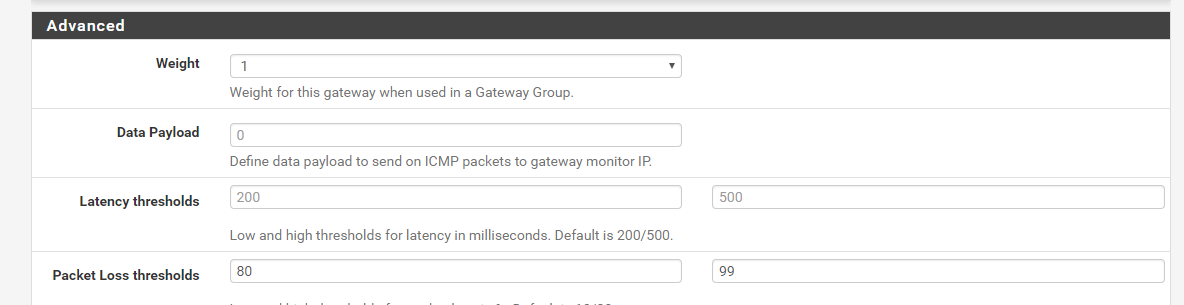

          Thanks for the replay. I changed my Monitor IP from the internal Router to the ext gateway ip again and also enabled the "Disable Gateway Monitoring Action" for now as it seems i can send 0 payload icmp packets (ping -l 0 gateway_IP) to the actual gateway this time around.
          You advised to give it more time. Do you mean the default 10/20 % values? I've set it to 80/99% today, but I assume that might be too high right? For now, I guess it does not really matter as I've Disable Gateway Monitoring Action.

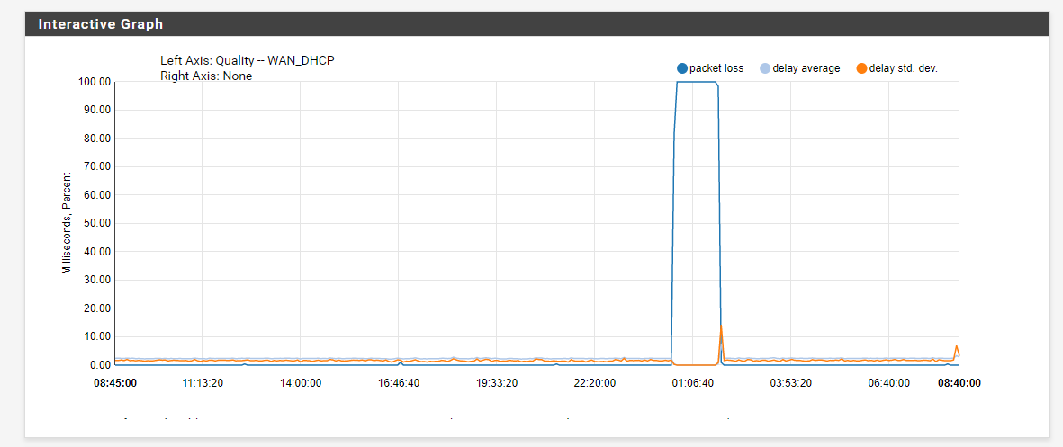

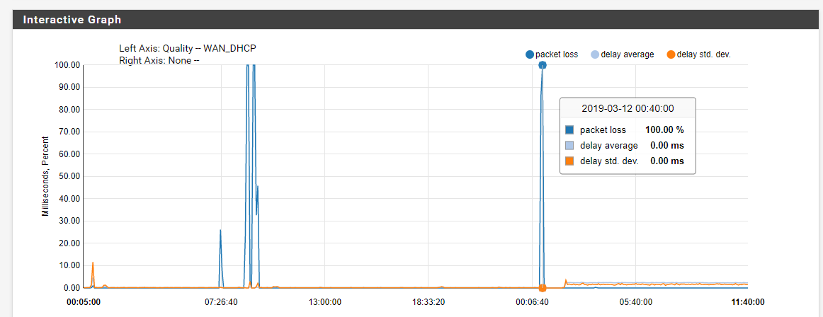

            This morning I found that at the exact same time, I start to receive alerts again of 100% packet loss at 12:30. This time I had disabled the gateway actions and increased the log buffer. I did not see any outage as I was in bed, but it seemed to be working this morning when. It also looks like I got a new wanip at 01:04 and 01:50.
            Because I see "sendto error: 65" and "sendto error: 64", I assume I was offline for that time?
            So what exactly does the gateway monitor do if it was enabled vs disabled and recovering on its own?
