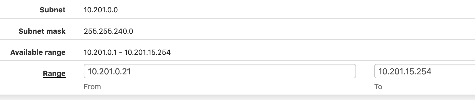

      I have my dhcp configured like that, it seems to be working but, recently I started acting and besides upgrade to 2.4.4-RELEASE-p2 (amd64) I did not do anything.
      Any static IP outside of range defined here does not work
      1. tested on 2 computers off physical port (windows, mac) e.g 10.201.0.11 or .12 with subnet /20
      2. can't even ping gateway 10.201.0.1
      3. dhcp seem to be working fine, I get address and it works off physical port and wifi (I can browse internet)
      4. since this interface is used on wifi some users started complain that they are unable to connect, they don't get IP address. Old devices that were connected here before work fine, cant replicate.
      5. Logs does not show problem to me, especially dhcp logs except that service may have restart

      update: 12) I removed this interface, recreated rules and dhcp settings including rage and static IP still does not work. I have noticed that my iphone after this procedure still keeps old IP so lease was kept.
      1. I just checked routes and sth is not right all networks behind NAT have gateways that points to link#NUMBER but the one I am interested is pointing instead to IP 10.201.0.2 instedad of .1 or link#
        mke
        I removed openVPN server and it started working. Sth must have happened after last upgrade
