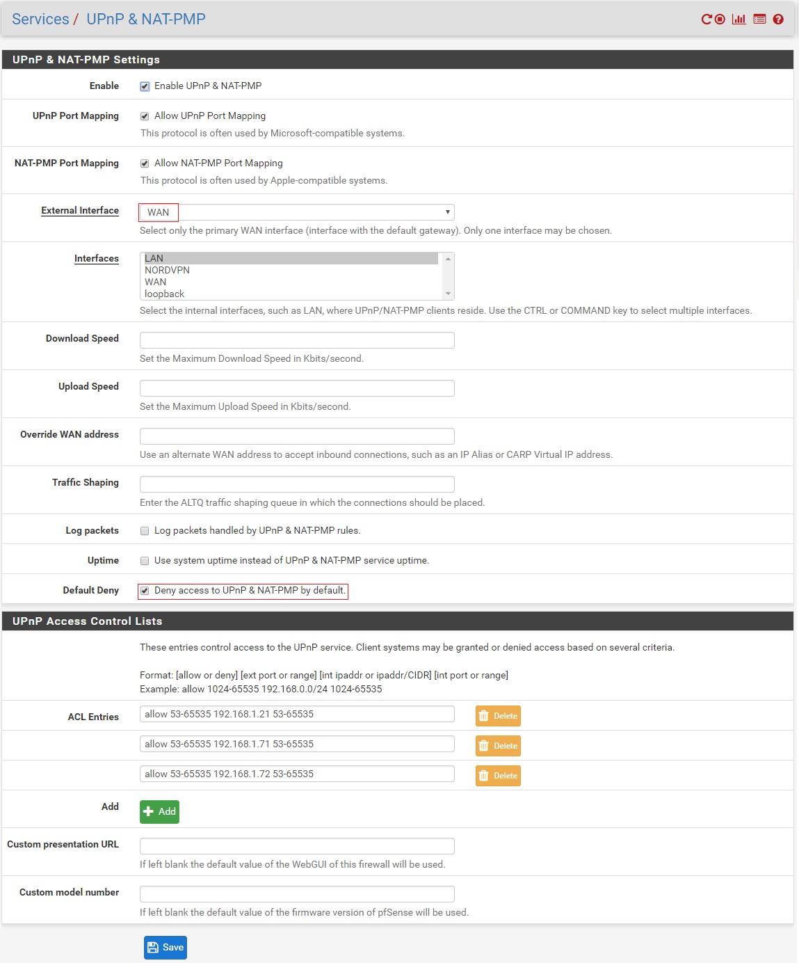

      uPNP
      As mentioned before, I like uPNP for administrative reasons. I know people are against it because of security but that is another topic. I have set my uPNP as shown in the picture below. Make sure you select your WAN and LAN interface correctly. I also found guides that mention that the IP address should be in the format of 192.168.1.21/32 but that didn't work for me. It is possible to not select the Default Deny option but then the uPNP list will fill up with devices that try to use uPNP but are blocked by the firewall rule created later on.

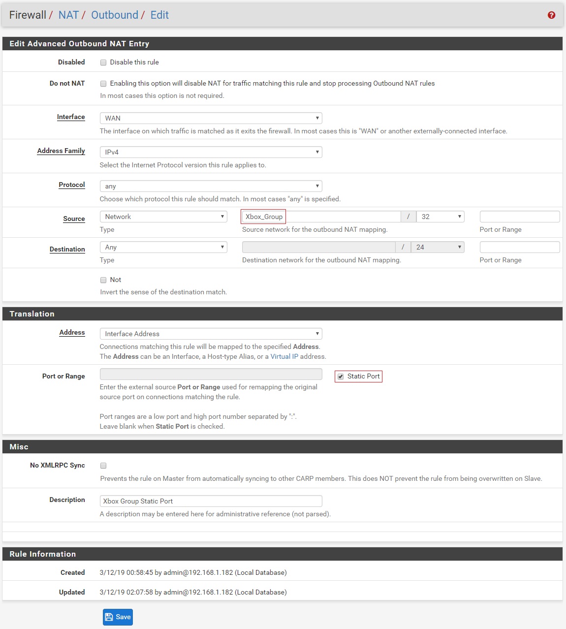

      The Xbox does not like dynamic NAT ports so it is important to change that to static. I did the same for my Plex Media Server but that is optional. I used the aliases as a source. These rules will not open specific ports, it just makes the ports, created by uPNP, static.

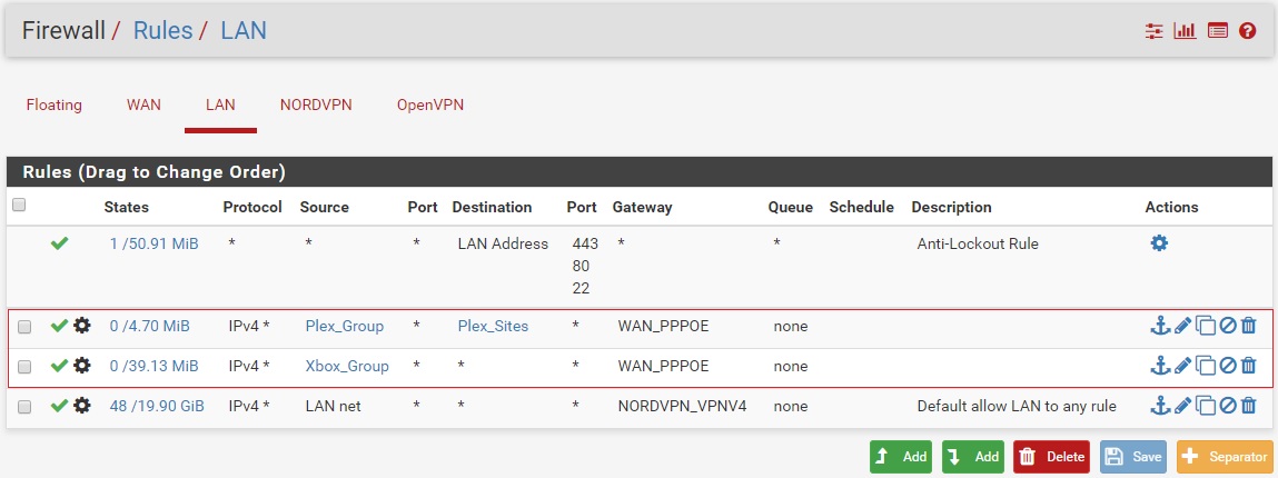

      The result should look like this. Notice the rules for Plex_Group and Xbox_Group are on the top while the NordVPN rule is almost (!) at the bottom. Don't place the NordVPN rule under your 'Auto created rule - LAN to WAN' as all your traffic will try to default NAT out your WAN interface instead of the NordVPN interface.

      So the NAT rules are in place but to be allowed to get it out the correct interface, we have to add two more firewall rules. Notice that the rules are located above the 'Default allow LAN to any rule'

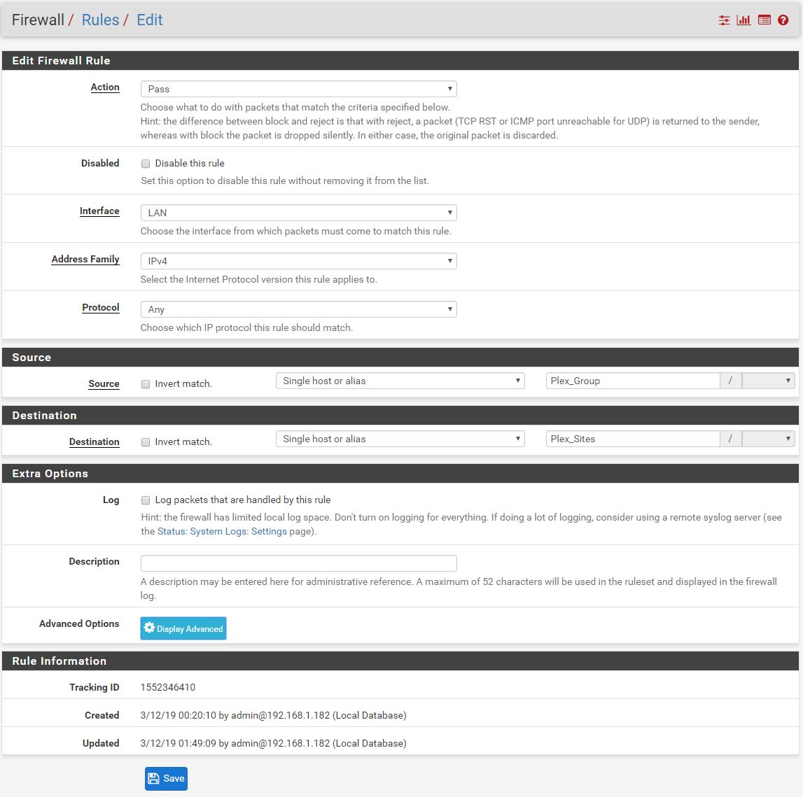

      The two pictures below show the firewall rule for Plex in more detail. Notice the aliases used in source and destination. Make sure to click Display Advanced to change the Gateway
      This should do the trick. Your Plex server don't need a manual port now and will still be accessible from outside. Also your Xbox will have an open NAT.

            The Plex_Sites alias is made to redirect traffic for these sites over the WAN link (instead of the VPN). So only if the Plex_Group wants to go to the Plex_Sites it will go over the WAN. For other sites, the VPN is used.
            My PMS server (Windows server) will use uPNP over the WAN towards plex.tv to enable Remote Access. But if the same server is going to Google.com, it will go over the VPN.
