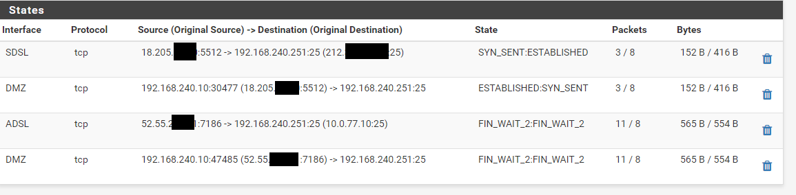

      Wan2 (SDSL) is acting strange. I can see that the nat is working (tcpdump on destination shows correct source 192.168.240.10. But for some reason, the pfSense is not getting the syn ack or is not able to process it.

      This is the states table (ADSL is the working connection, SDSL the not working one):

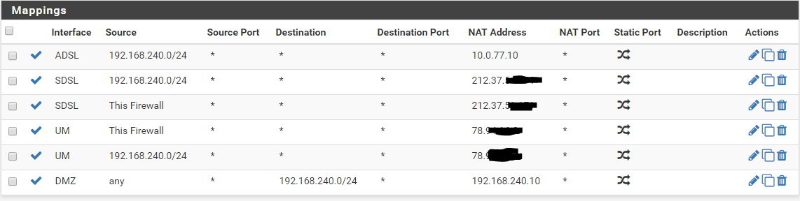

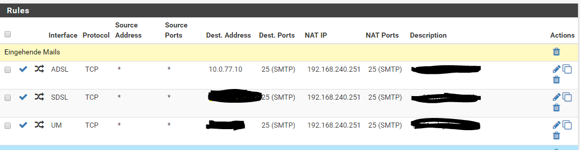

      Edit: This are the nat rules
