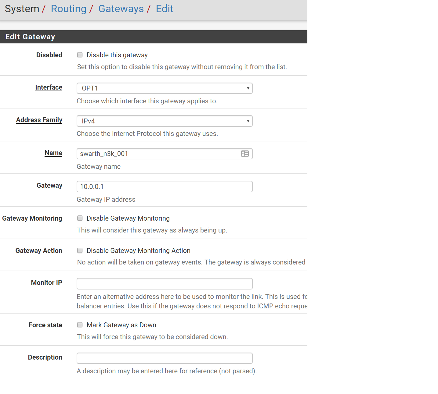

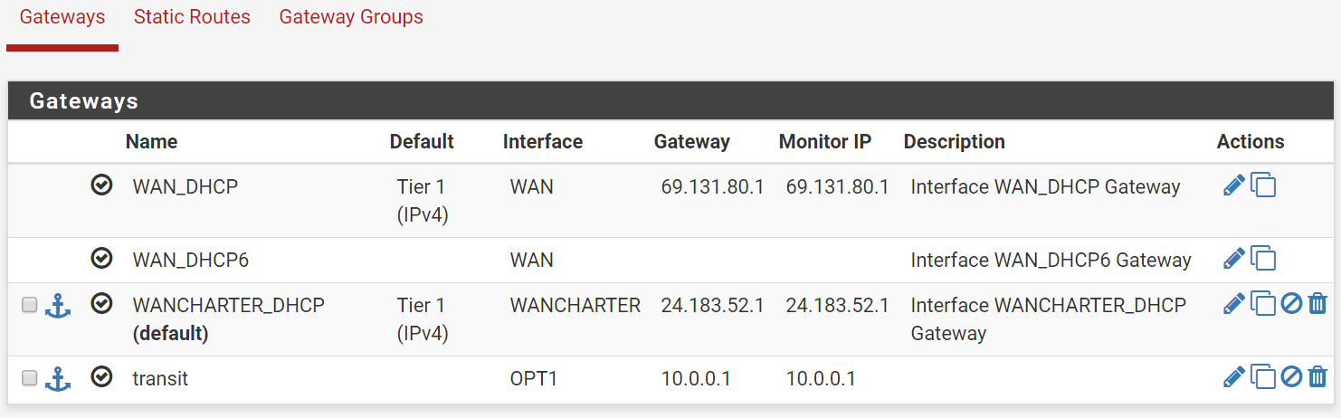

OK, I just removed the upstream gateway from the OPT1 interface. I do have the gateway created and the routes for the downstream networks, however, I still can't get to those downstream networks from hosts using the pfsense as the default gateway.

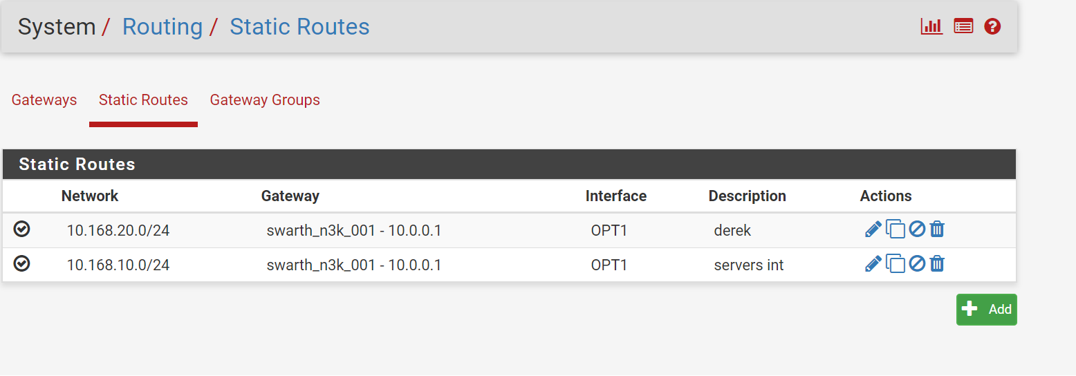

Attached screenshots of the gw and static routes.

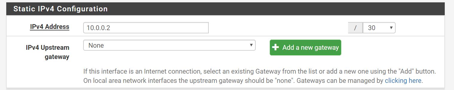

By Interface, I assumed you mean the interface that I see when I go to Interfaces -> OPT1. There is no upstream gateway set there. On the edit gateway screen, if I don't put anything in the gateway field, it says "dynamic". I don't understand how this is supposed to work if I don't tell PFsense what the downstream router IP address is.
My assumption, which is obviously wrong, is that I have to configure an interface on PFsense (interfaces -> OPT1) and then tell PFsense what the downstream router IP address is (System -> Routing -> Gateways), and then create a static route to tell PFsense to use this new gateway when going to certain networks. The routing table on the box seems to indicate that the way I have it configured is correct -
10.168.20.0/24 10.0.0.1 UGS ix0And ifconfig shows the configured 10.0.0.2 IP address on ix0.
Can you tell me what I'm doing wrong? The current state is that the system is configured as you show above (again, with my pfsense interface being 10.0.0.2 and downstream being 10.0.0.1)

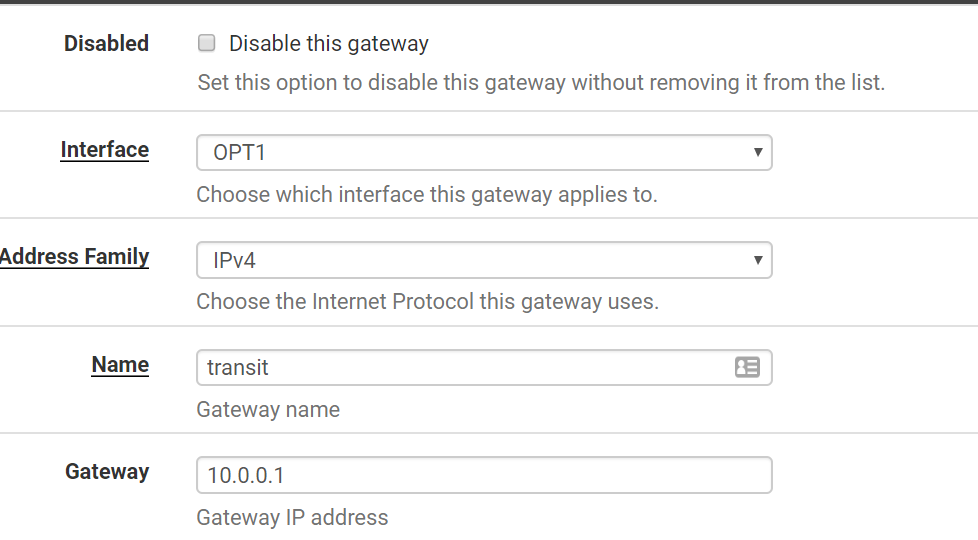

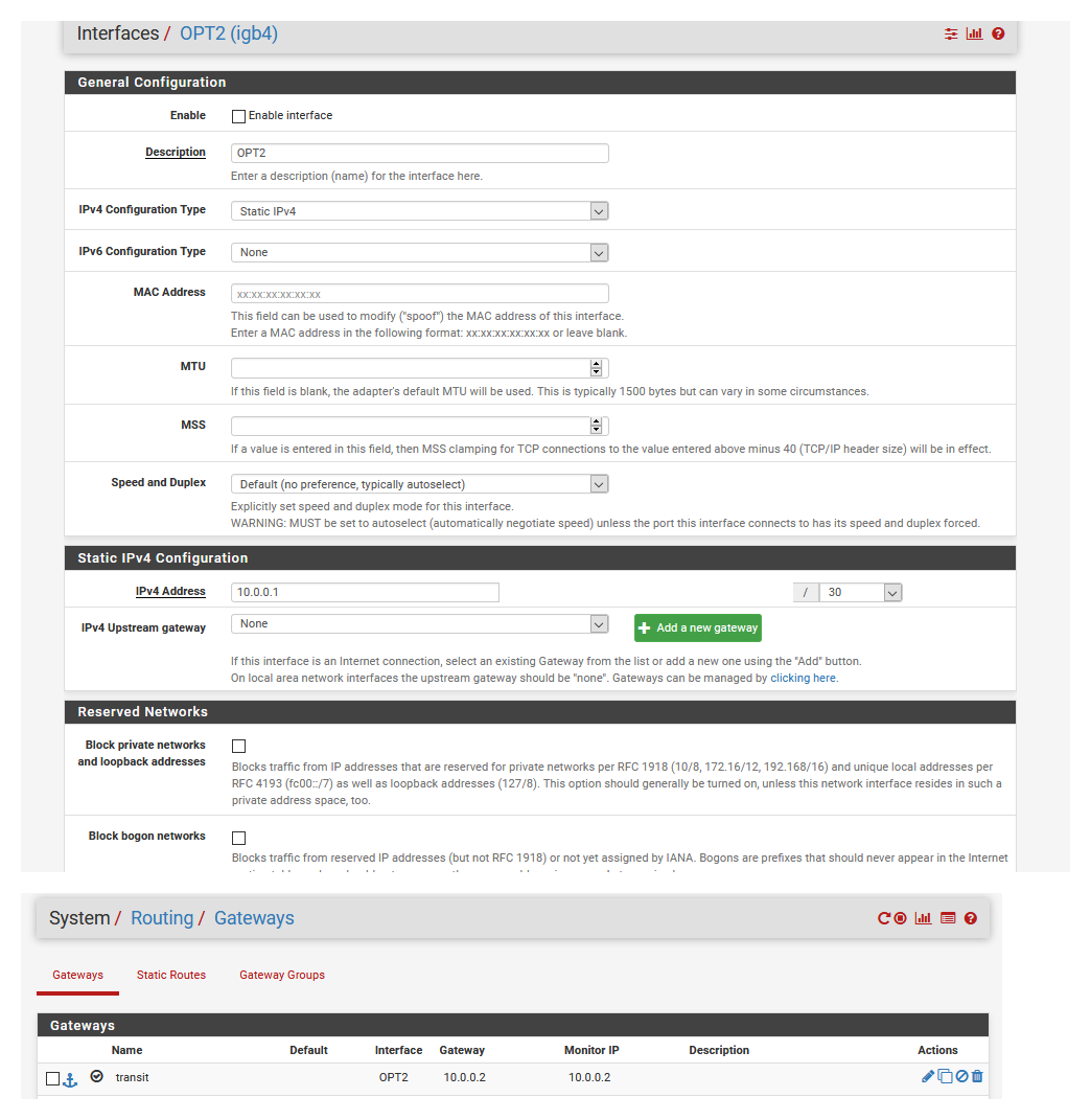

Dude I gave you a freaking picture of how to do it - how can you not understand this basic concept??
So I flipped IPs in my picture - sorry... But come on who cares which side .1 or .2 is on... The point is NO gateway on the interface!!! This is the 4th time stating this..
Normally is the upstream router that would have the lower number..
Again if you put the gateway on the INTERFACE!!! Pfsense thinks is a WAN!! And will now NAT to this ip, etc. You do not want that! Its not a wan, its a transit to a downstream router.. That is not public. Since its a "lan" interface there is not gateway set on the interface.
I do not have a gateway specified on the interface.
I do have a gateway set on the routing -> gateways -> edit.

- "System -> Routing -> Static Routes" should have a static route for all networks behind the Nexus with a gateway of 10.0.0.1 (Looks like this is done)
- "System -> Routing -> Gateways" should have an entry on OPT1 with a Gateway of 10.0.0.1 (Looks like this is done)
