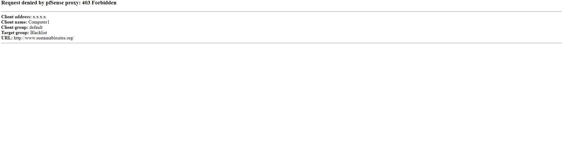

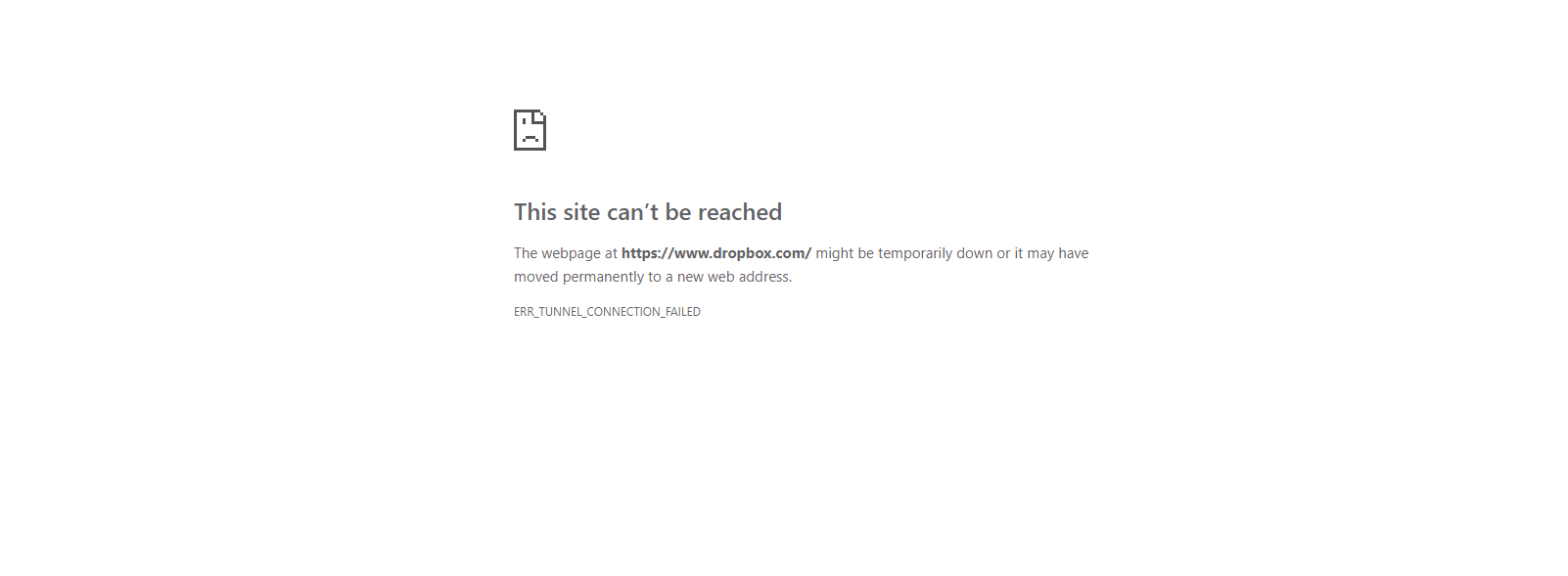

      I am seeing a issue where I am getting two block pages one for http sites and one for https sites.
      The http blocked page takes me to the SquidGuard blocked page but the https blocked page shows as a "This site can't be reached"
      http blocked page:
      https blocked page:
      Is there a setting I can change so all https blocked sites will use the squidguard blocked page?
      Thanks,
      Jord
      • KOMK Offline
        KOM
        No. This is just how it is for https connections.
