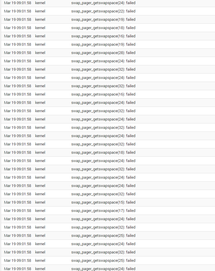

      Hello,
      I have just checked my logs and noticed a lot of "swap_page_getswapspace():failed (See image below)
      How would I go about fixing this?
      Thanks,
      Jord

          • NogBadTheBadN Offline
            NogBadTheBad
            What version of pfSense are you running ?
            It looks like you are running out of swap space, the following should tell you the process that's eating all your swap space.
            Run top -w, press o then type in swap
            Andy
              J7529
              I am running 2.4.4-RELEASE-p2
              Running that cmd the top results flicks between Squid, ntopng & clamd
