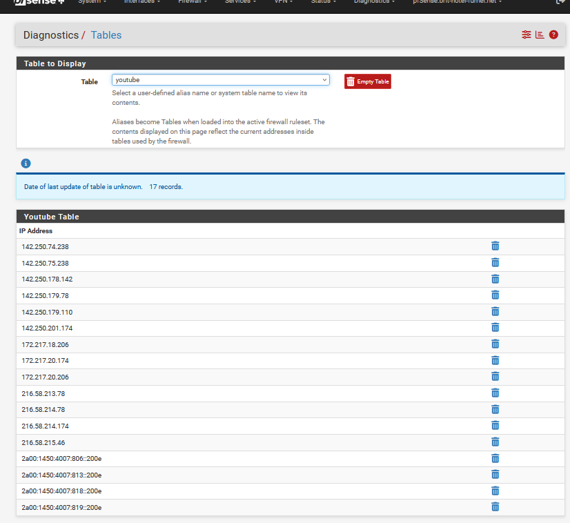

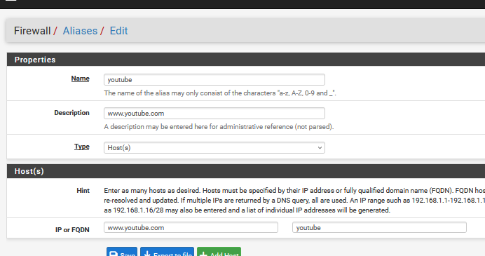

                                    So, throw "www.youtube.com" in a Alias :
                                    and now, go check this Alias :
                                    and by magic, the Alias get filled with the actual IPs. Even better : the alias will get refreshed this IP list every 300 seconds or 5 minutes.
                                    This works pretty well, and probably enough so the owner of "192.168.0.10" stops trying to visit "www.youtube.com".
