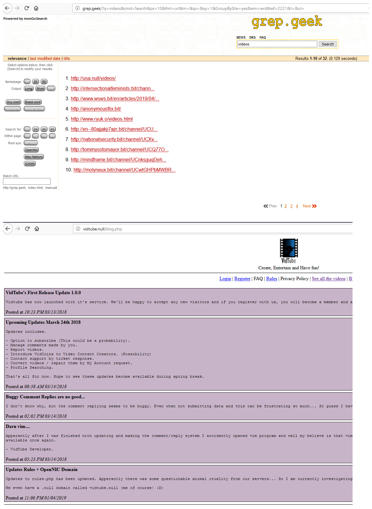

                                          I would be curious as well to what they are looking up.. but domain.null could be almost anything..
                                          Allowing for unbound to resolve opennic tlds is a simple as adding a few stub zones pointing to the opennic NSs..
                                          Here I added stub zones for geek and null so could get to search engine and fine a null site, etc..
                                          That snort marks them as suspicious could be seen a few different ways... For starters anyone trying to do something bad, writing code so it could resolve opennic tlds would be "extra" work ;)
                                          But maybe its someone trying to circumvent something??
                                          It could be just honest sort of mistake where a search suffix is adding .null to something and causing the query to roots for whatever.com.null for example..
                                          You have my curiosity cat meowing ;) So please report back what you find...
