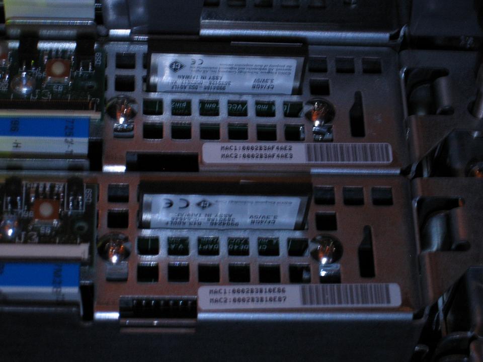

                  The ISP1100's are a nice, simple, low power solution.  Also marketed as the Dell PowerEdge 350, PowerApp 100, and a variety of more-obscure things.  The base platform is a competent 1U server that is capable of working headless, with full serial console support in BIOS.  One half height and one full height PCI slot available - no onboard video, though, so if you must have VGA, you eat a slot.  Also, outfitting memory is vaguely tricky, you have to use lower density memory.
                  We have one backup server that's an ISP1100 and it is currently out of the rack, and I just put it on the wattmeter.  It's pulling a total of 68 watts.  This includes an Intel PIII-850 CPU, 4 x 256MB memory. a 4GB CF card in a CF-IDE gadget, a video card, a SATA card, and a 750GB HDD.  Stripping out the HDD, SATA, and 3 x 256MB reduces that to 52 watts, which is just fantastic and unbelievable, compared to most of today's contemporary servers.
                  You can also do some really neat hacks with the ISP1100's.  For example, they come with a waffle-grid vent on the front.  Chewing out a few bars, we've converted some ISP1100's to hold a CF-to-IDE holder in the front panel, so that you can trivially remove/swap/upgrade the compact flash module without any problems.  This hack makes the ISP1100 a very attractive platform for use with something like pfSense.
