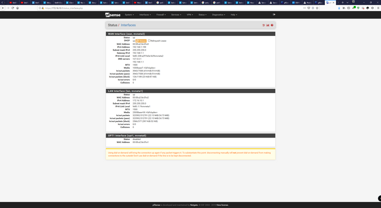

      I'm in the process of replacing my old Asus RT-AC68U with my brand new Netgate sg-3100.

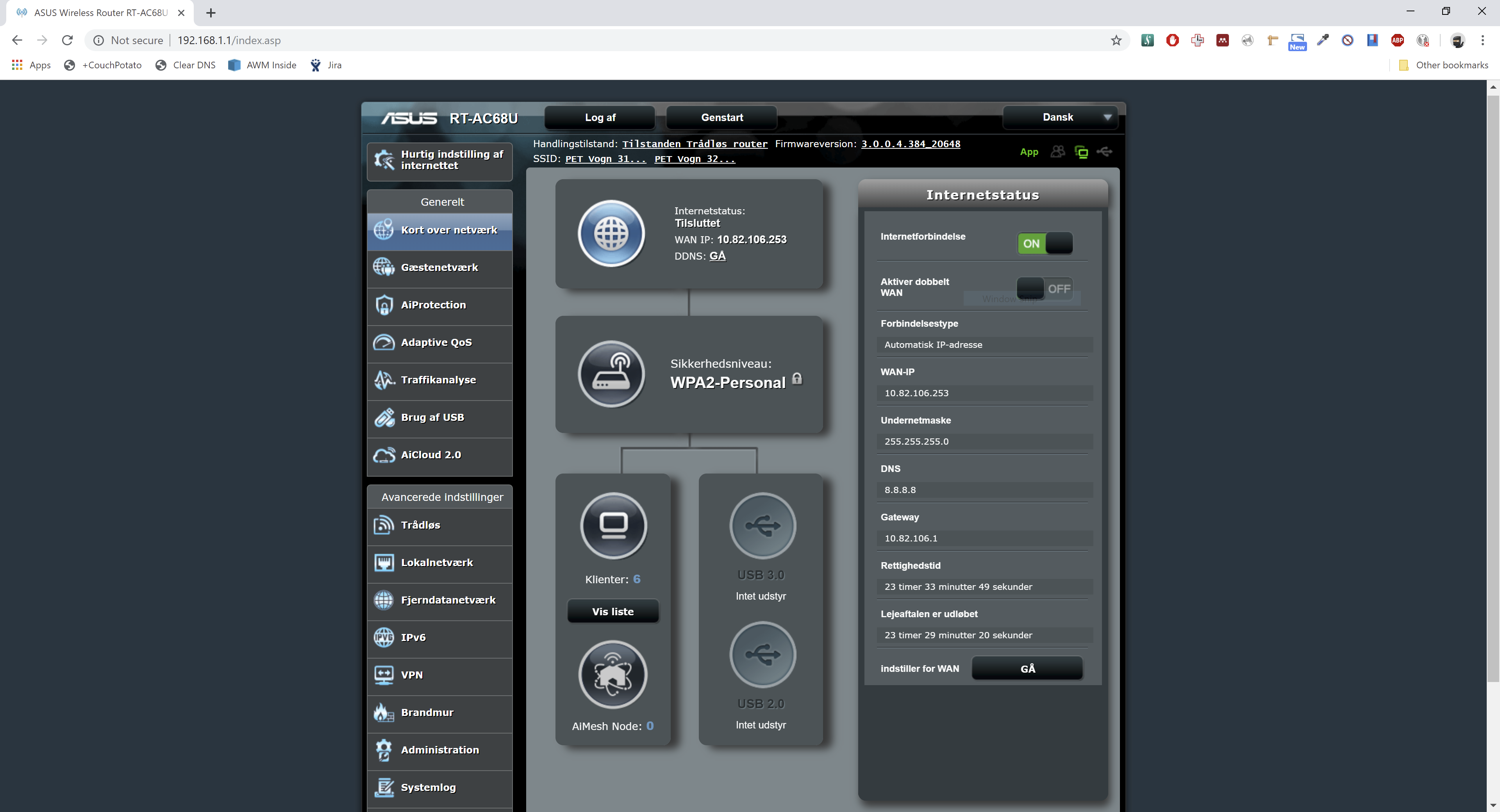

      The ASUS device was configured to automatically get DHCP config from the device provided by my ISP. This worked like a charm. I've attached a screenshot of the DHCP config it automatically received. The screenshot shows the gateway detected and the WAN ip (right side of the image).
      However! Setting up my brand new SG-3100 has been a pain so far.

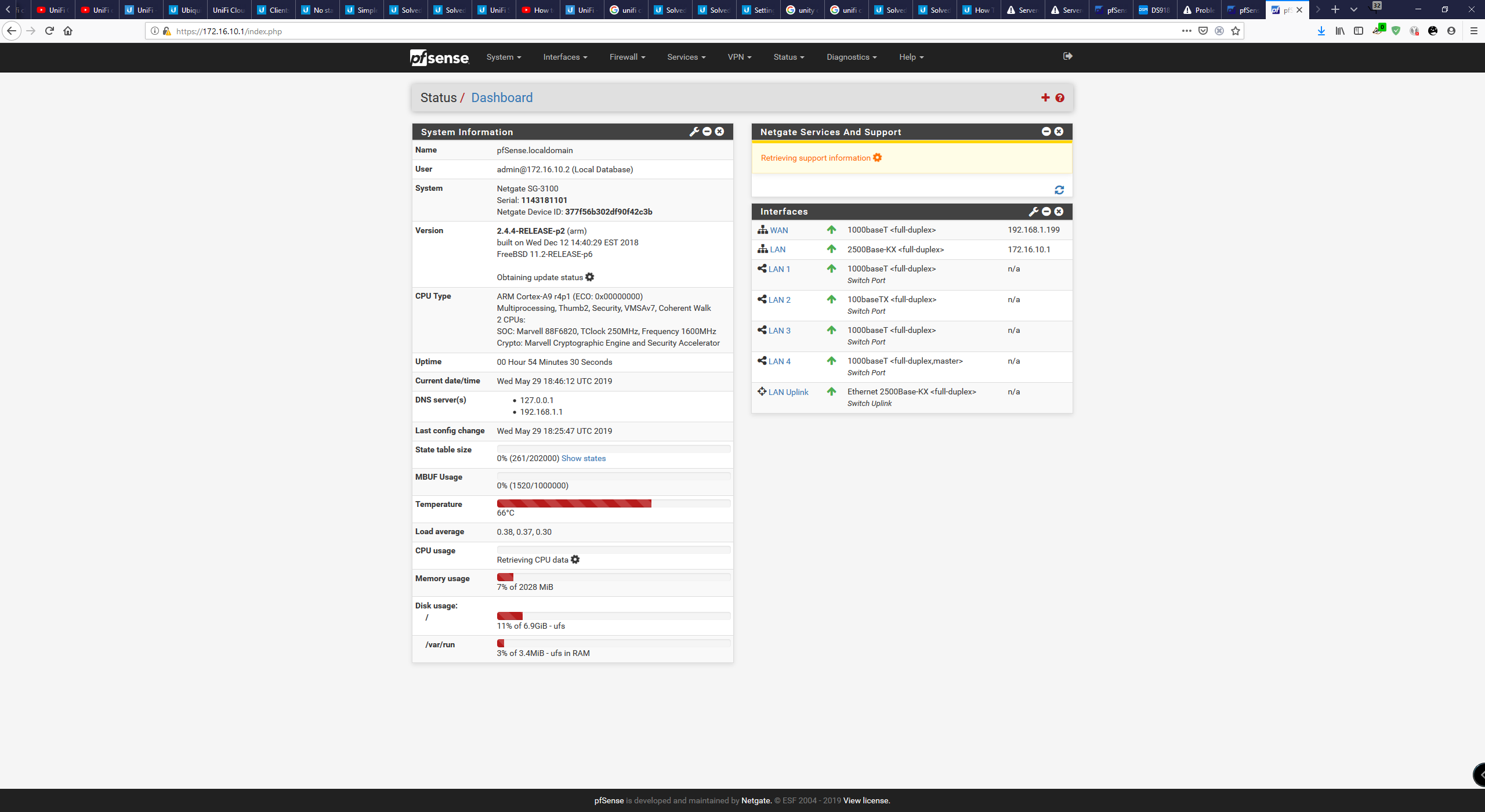

      The first issue occurred as I could not reach the SG-3100 at 192.168.1.1 for setting it up initially. It only showed up once I had unplugged the WAN ethernet cable. Only then I could reach the device and give it another IP.
      After the initial setup was complete, and I assigned my LAN to 172.16.10.0/24, I plugged the WAN ethernet cable back in. However, I'm still unable reach the internet with a simple ping request.

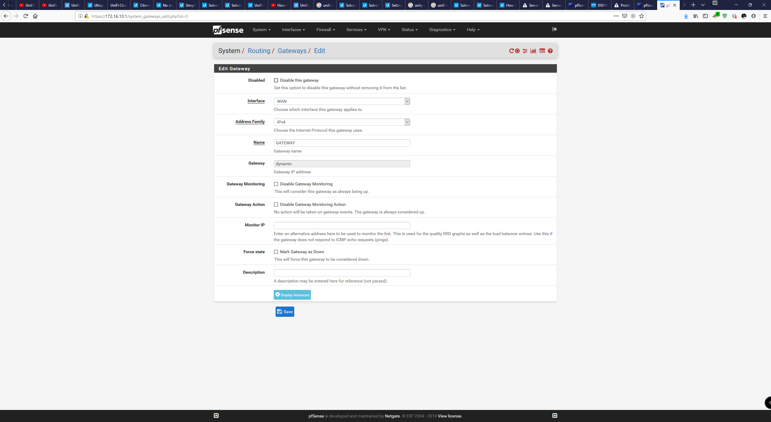

      I've attached a few screenshots of my settings, but is generally lost on what is the cause, since the ASUS device played so nicely. Note the ASUS device was acting as a router/firewall, not just an access point.
      With my current settings in pfsense, whenever I do a traceroute of 8.8.8.8, I end up at 192.168.1.1 with the message that the destination net is unreachable. Interestingly, entering 192.168.1.1 in a browser gives me the login page of a zyxel device that is not mine. The twist to all of this is, that I live at a dorm, which has its own IT equipment responsible for distributing the internet to all the residents that I cannot control/modify

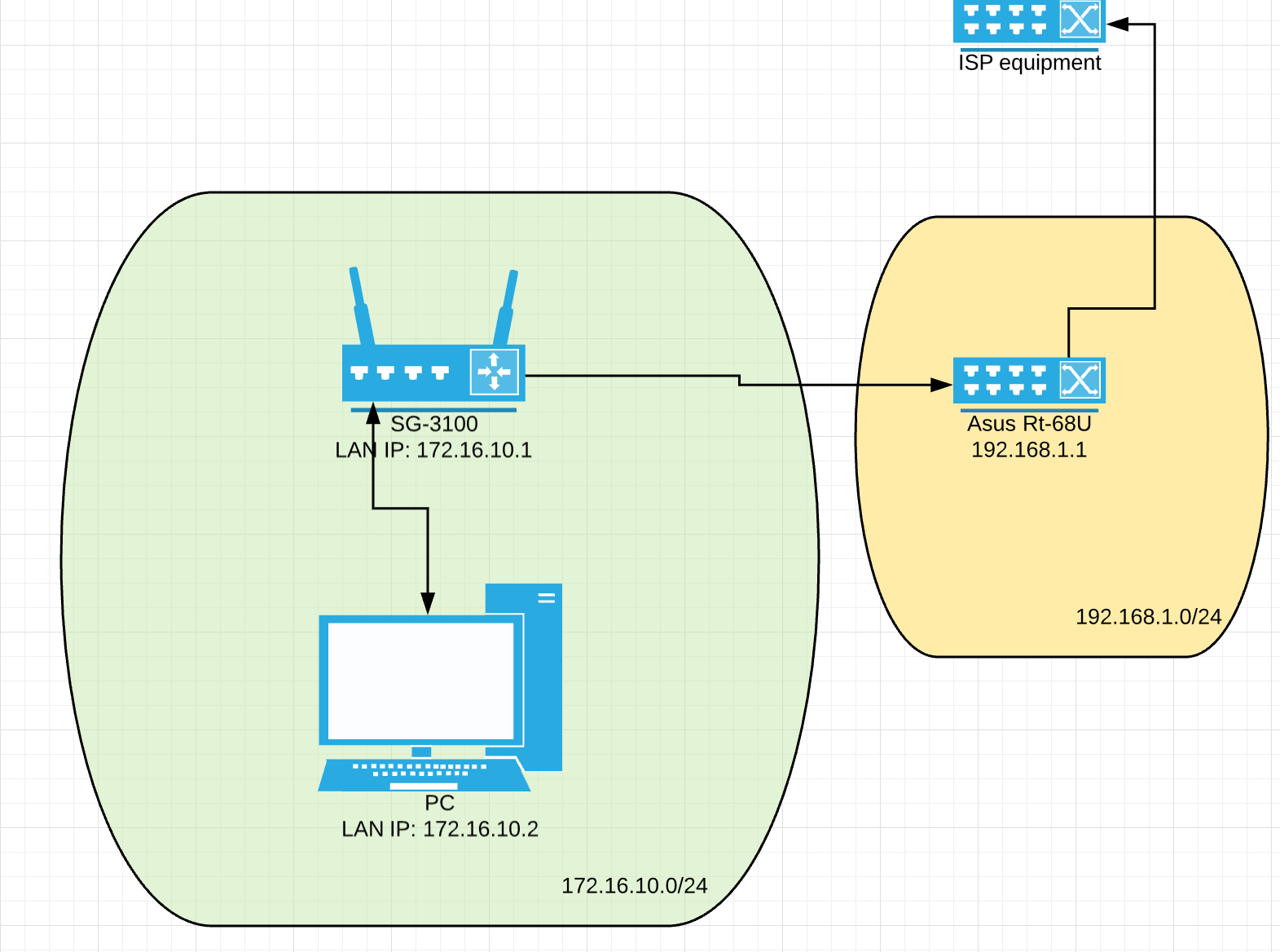

        Please provide a simple network diagram showing how you have this connected.

          It's actually a super simple setup for now.

              Interestingly, this more complicated setup works..

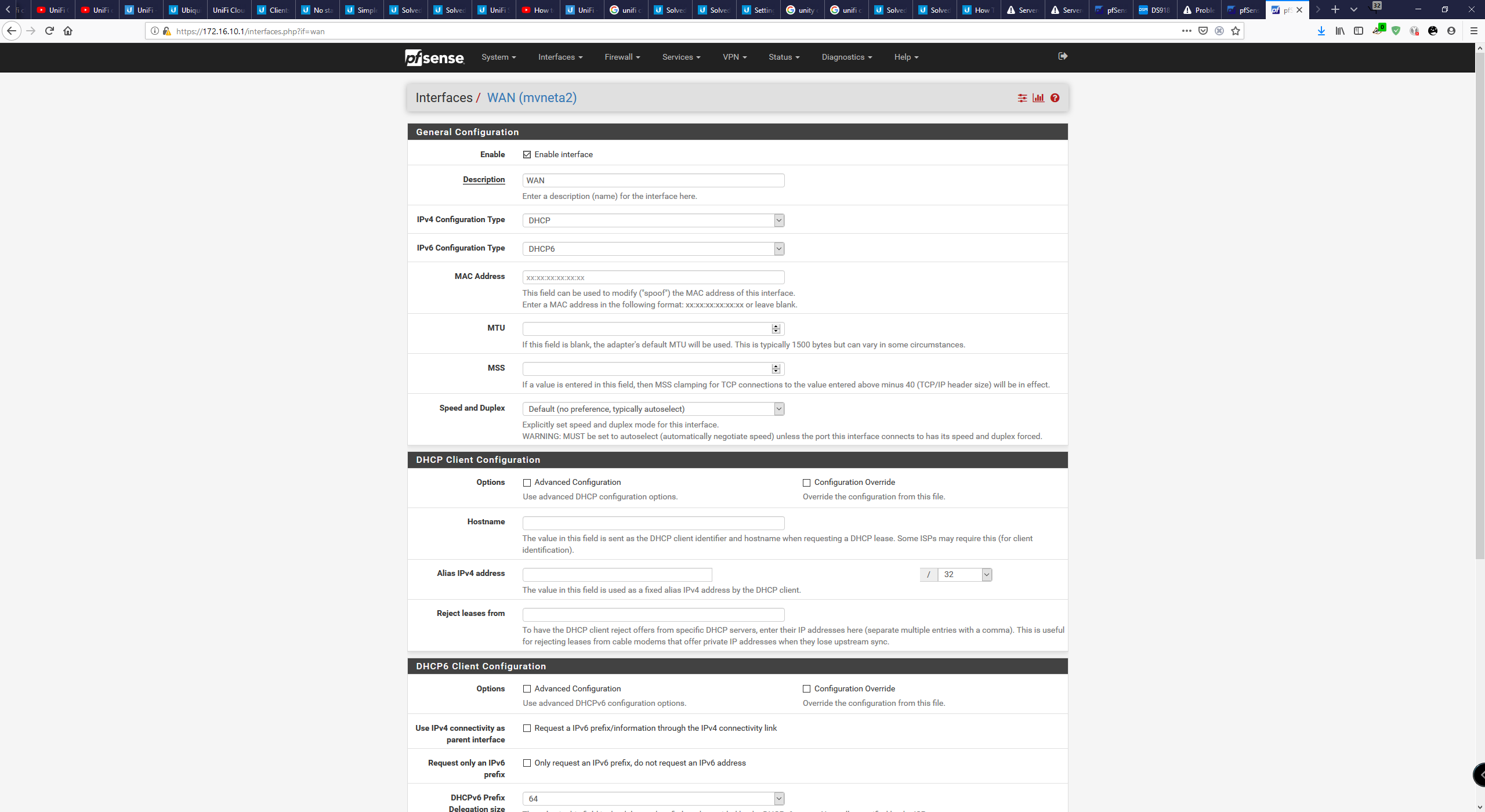

                    @mkkl Hmm, does the ISP/dorm use some ACL, allowing the ASUS but not SG-3100. Try copying the ASUS' mac.
                    To recap, the issue is that you cannot get to the internet and NOT the fact that Zyxel responds to 192.168.1.1?
                    • M
                      mkkl @bartkowski
                      @bartkowski You're the best!!!
                      Entering a mac address in the mac address field of the WAN interface fixed it!!

                        Also, I noticed that Asus shows a 10.x IP on WAN, but SG gets a 192.x on WAN - all while connected to the same cable coming from ISP[?] - why?

                            @bartkowski That is a very good observation and something that I've also pondered on. I have no clue why that is, but now my sg-3100 also gets 10.x WAN ip as the asus did when it worked.
                            As a matter of fact, it turned out that entering any MAC address would fixed the problem, not just the mac of the asus device.
