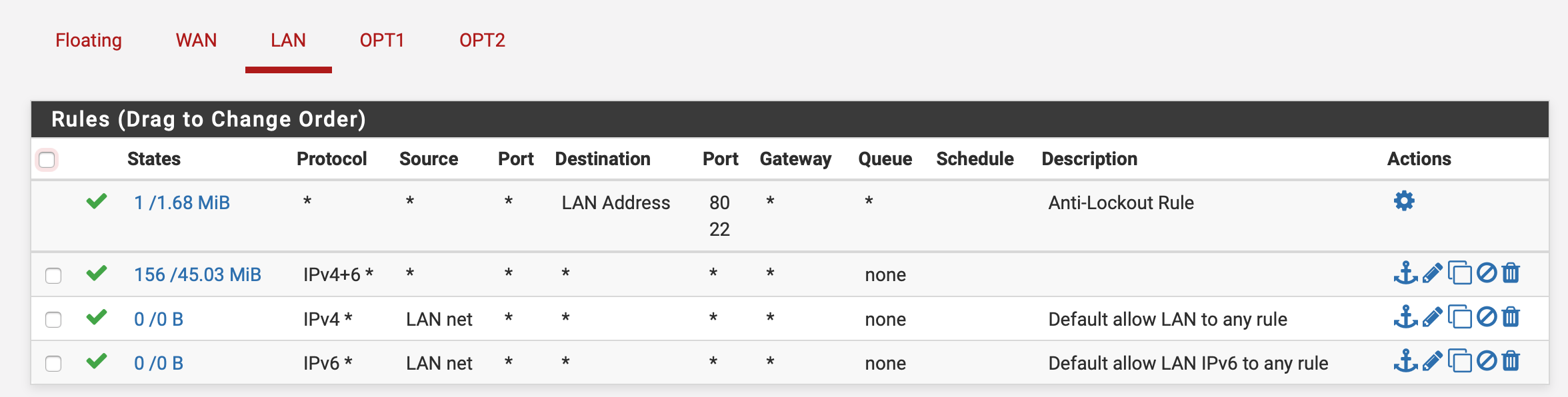

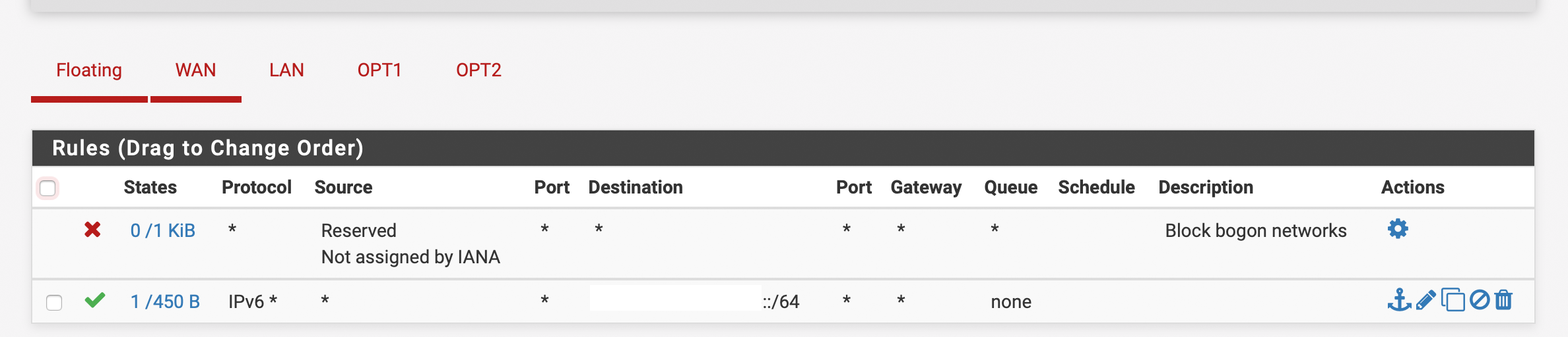

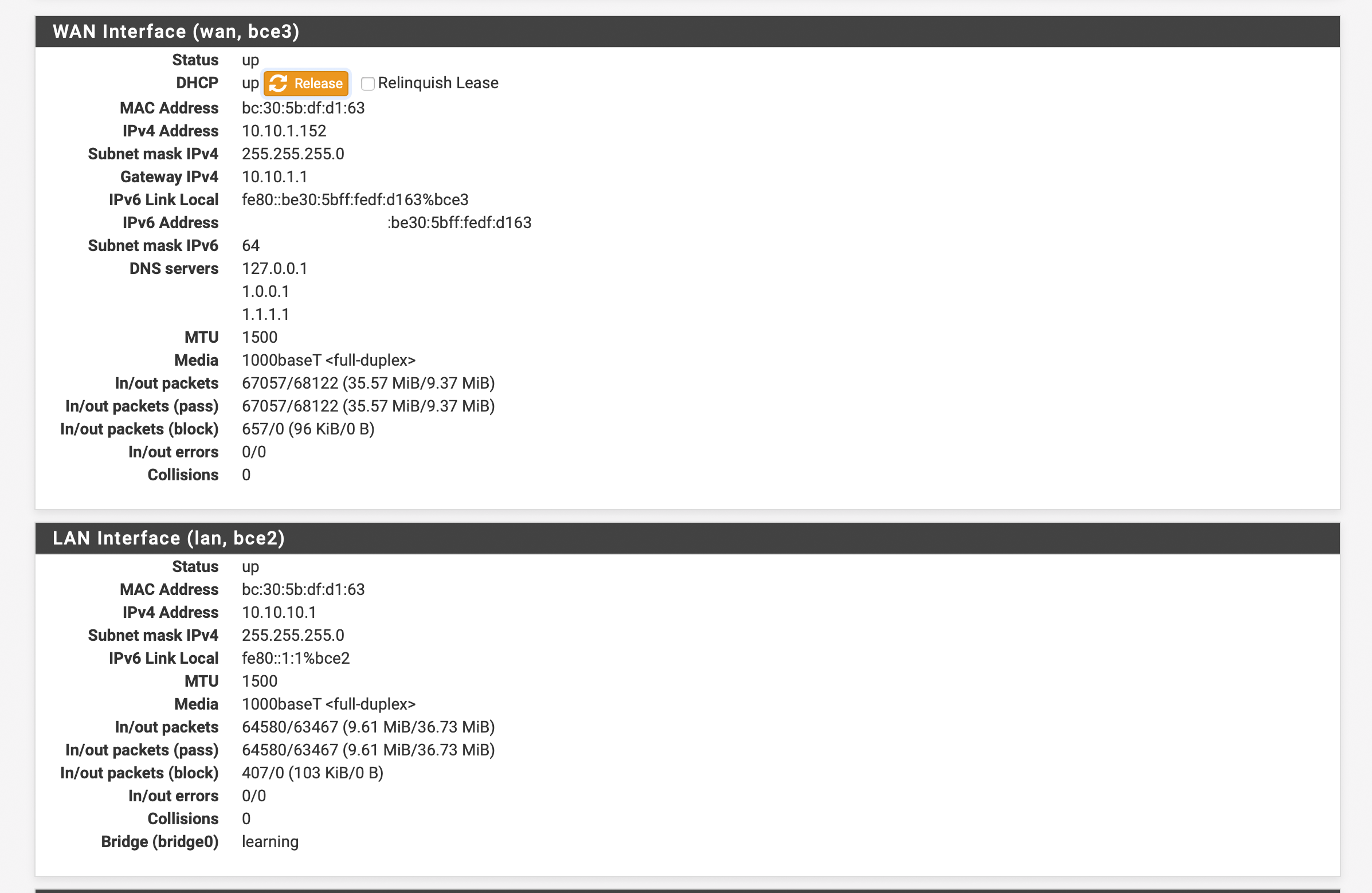

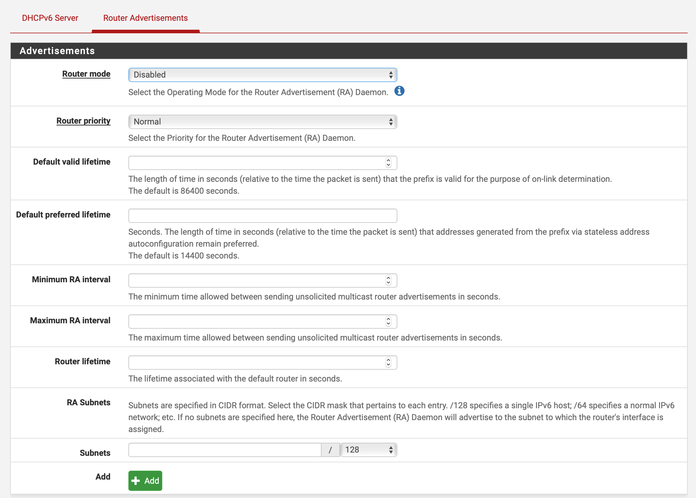

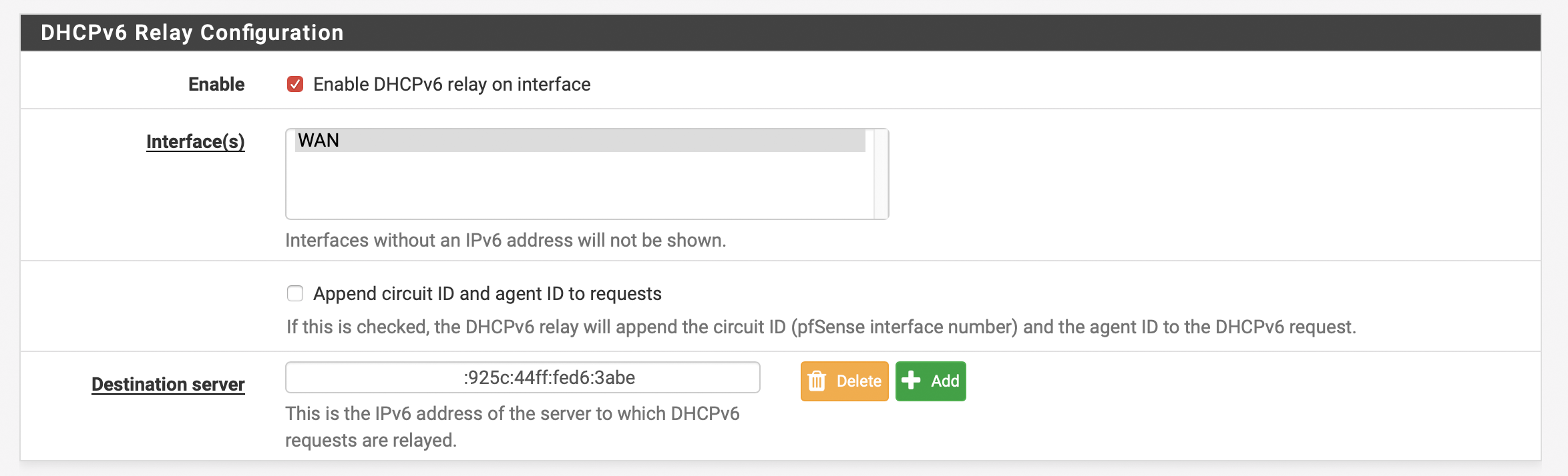

      I'm having trouble with setting my IPv6 up correctly. Maybe my situation is unsolvable, at least it's not ideal and I know that:
      • I'm getting one /64 subnet by my provider only,
      • pfSense is behind a router, which I can not set to bridged mode (currently).
      So I set up pfSense WAN to DHCP on both IPv4 and IPv6 and LAN to track the IPv6 WAN. IPv4 uses a different subnet and it works as expected. I set up the DHCPv6 relay, so I would expect that I get a valid IPv6 address from my router, which is unfortunately not the case. Neither can I set up the IPv6 manually on devices that are connected to pfSense, at least I'm not able to ping anything outside ::1. When I connect a device to the router, it gets an IPv6 address and everything is working fine.
      I have to admit I'm a total noob in this area, and I have been working on this 6 or 7 hours straight, also reading up on IPv6 without understand it completely (otherwise I guess I would be able to solve my problem or know that it's impossible to solve). Please see the screenshots attached. Any help would be gladly appreciated and of course I would provide more details if necessary, however I have no idea where to go next, so I don't know which information I should provide in addition to this. 😕
      Thanks for any help!
