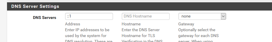

        A minor interface glitch - empty the last line like this :
        and Save.

        I think pfSense is missing something in /etc/resolv.conf
        The ::1 !
        That's why I set things up like this :
        So I wind up using a classic default 'FreeBSD' /etc/resolv.conf like :
        [2.4.4-RELEASE][root@priv.brit-hotel-fumel.net]/var/unbound: cat /etc/resolv.conf
        nameserver 127.0.0.1
        nameserver ::1
        search brit-hotel-fumel.net
