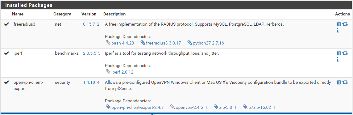

      The pfsense device is running
        jkamal
        Packages:
        Of these, the iperf one is not in actual use at the moment but it is installed. There is no active VPN server.
