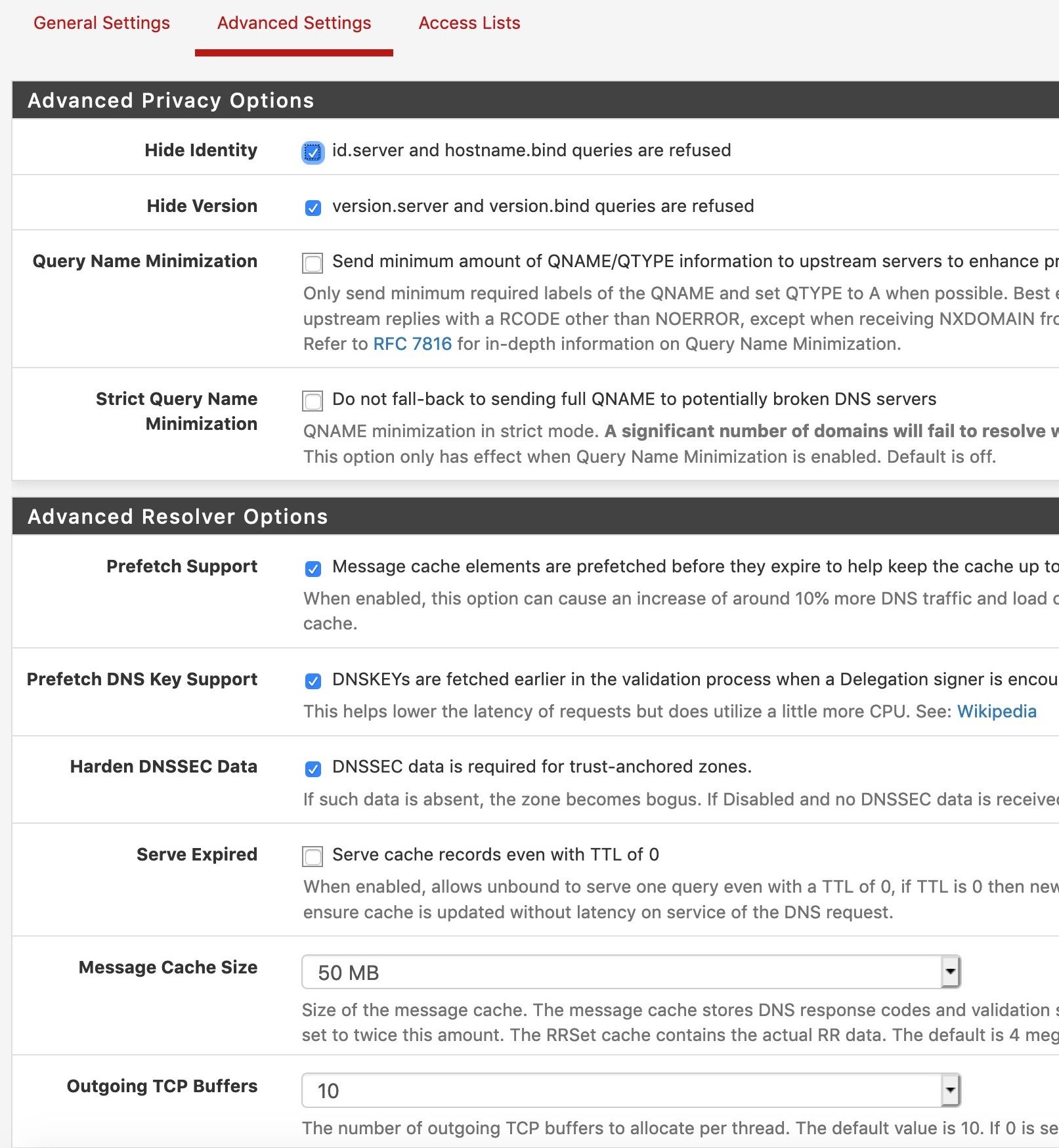

      • These are my settings, have I done it right or is there something I should change?

          @occamsrazor said in Understanding DNS validating resolver w/ DNSSEC vs DNS-over-TLS and interception:
          Yep.
          Are you sure this is used by any of your devices on LAN ? :
          occamsrazorO 1 Reply Last reply Reply Quote 1
            Yep.
            I don't think it is being used. I ticked that box when I was setting up DNS-over-TLS and kept it listening, just in case I did for some reason have a device that was using it. But I assume there's no harm to having that running even if you aren't using it?

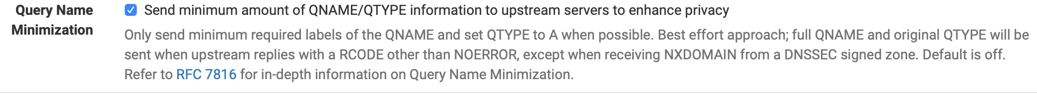

                  For further perspective, in this situation I personally would run Unbound as a true resolver, rather than a forwarder, and keep the following option on:
                  Screen Shot 2019-06-19 at 9.21.33 AM.png Do not turn on the strict mode - it will break a lot of stuff.
                  Caching queries and sending minimal content upstream, getting it from the source whenever possible, is going to prevent as many queries as possible from passing through your ISP, as well as ensuring locally that DNSSEC is in fact valid/trustworthy in as many parts of the chain as possible. In addition, queries will be minimal (if you already know where the root for .com is you don't need to ask again until that info expires, for example) and thus require more effort on your ISP's part to reconstruct (if that's what they're trying to do).
                  If they're taking port 853 off the table despite your wanting to use it, no sense in making it any easier for them to mess with your DNS :)

                      Thanks. I will try turning Query Name Minimization on.
