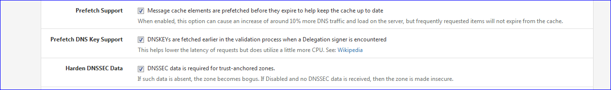

                            Btw : I've also set these on the Services => DNS Resolver => Advanced Settings page :
                            The last two options enforce DNSSEC handling, which means (to me) : if DNSSEC is wrong, then I can't visit that site. Not a problem for me, because sites admins that use DNSSEC better have settings correct. If not, their site will dissapaer from the net, for those who use DNSSEC for what it meant to be : getting correct DNS info - or nothing else ("domain not found error").
                            DNSSEC info is just like classic DNS info, although, because of the much bigger info records, the traffic - DNS requests and/or answers , will go TCP instead of UDP. (you permit DNS over TCP, right ?! DNS isn't only UDP port 53).
                            Option "Prefetch Support" explains itself : it keeps my cache up to date - as I mentioned above.
