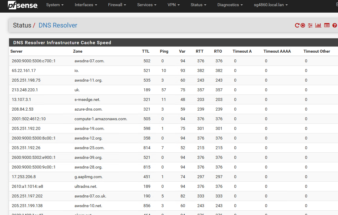

            Well what does the unbound log say about your query? UP the log level - if its actually running.. What error do you get when you try and do a dns lookup in the gui? What happens?
            What does your dns status show? It should show you all the NS its talked to that are in its cache, etc. you should not see any timeouts, etc. etc..
            example here is part of mine
