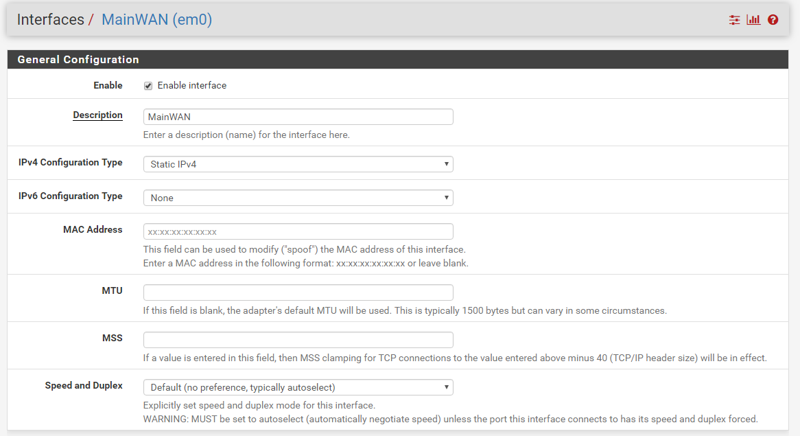

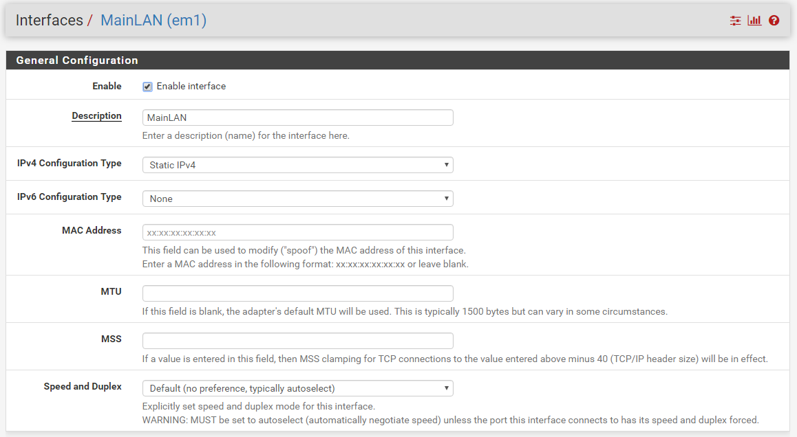

          Here are screen caps of all my settings I am not sure what you are recommending I change.
          ![interfacewan1.PNG](/assets/upinterfacewan2.jpg loads/files/1565551542468-interfacewan1.png)
