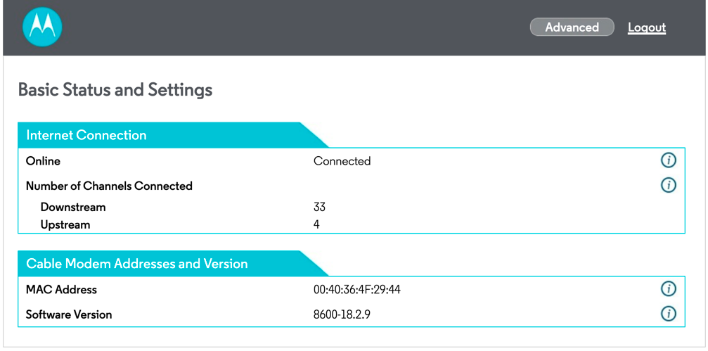

              I have Cox and a Motorola 8600 too. It just worked for me.
              I do not have an address on the modem, however, so that's different:
              It looks like my firmware version is about a decade later than yours.
              Chattanooga, Tennessee, USA

                  You should not have to do anything. DHCP will assign your WAN address, subnet, and gateway.
                  Your firmware version looks ancient compared to mine. I would start there.
                  https://motorolamentor.zendesk.com/hc/en-us/articles/216091737
