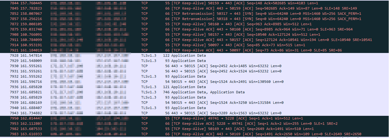

              This is what I see in Wireshark when the connection is failing:
                Hmm, all of those packets are tiny. Unlikely to be an MTU issue.
                You are seeing traffic back from the target too so the route is good.
                Hard to say why it's failing then. I don't see any RST packets there.

                      The error I see over the wire is the error I posted from wireshark.
                      I have nothing else to go on to debug..
                        The only actual issue I see there are two re-tranmissions but that may be normal packet loss. Not really something that should kill the connection. You are seeing traffic in both directions there.
                        Was that pcap on the WAN? How was it filtered? Do you see anything different on the internal interface?
