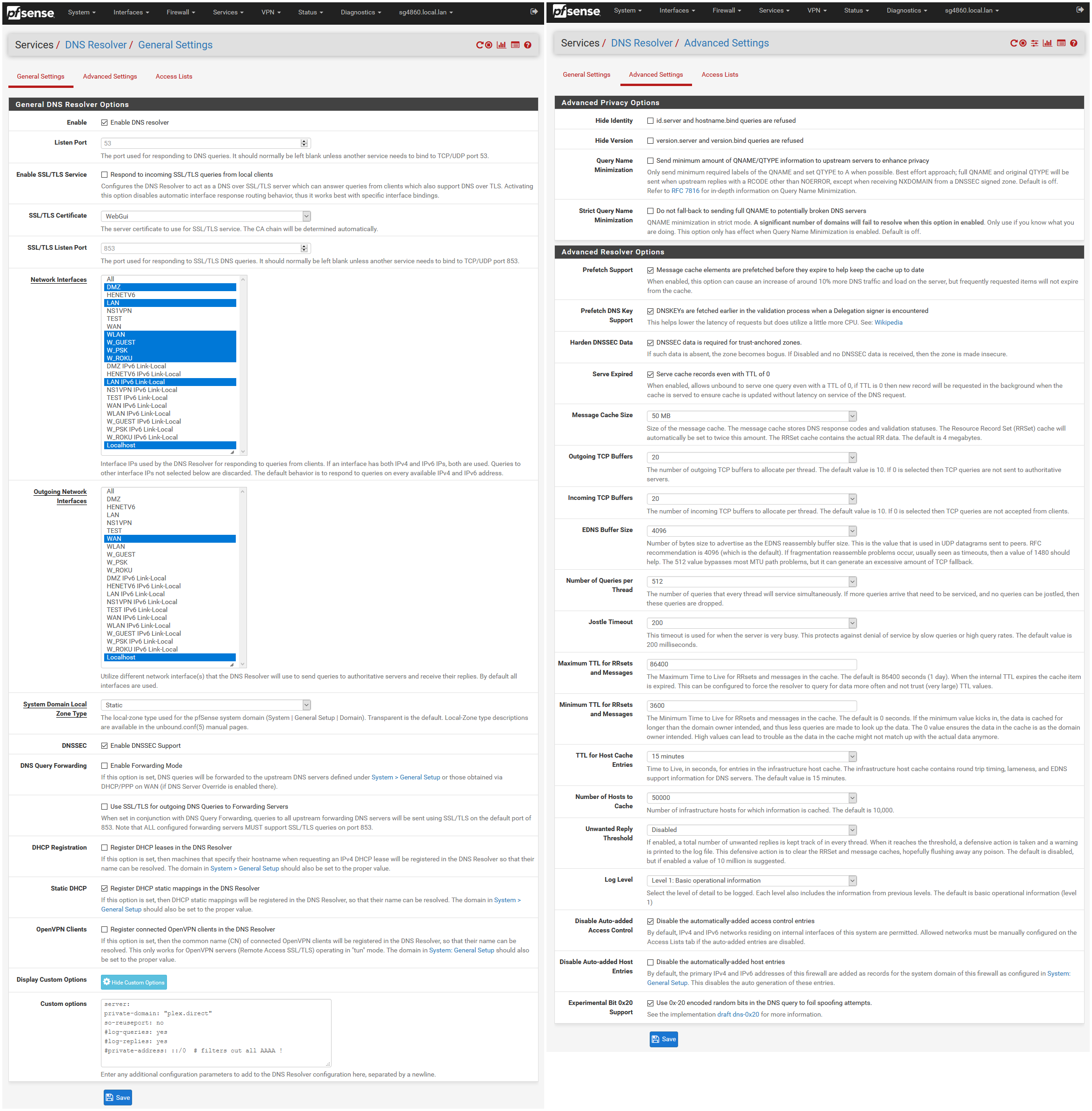

              mrsunfire @KOM
              @KOM said in DNS Resolver not caching correct?:
              Maybe I missed something in the dozen+ posts on this topic, but why does it matter? 0ms vs 12ms is barely noticeable and it only applies to lookups.
              Because more than 0ms shows that its fordwarding too root servers and not resolving from cache. Thats the reason I use unbound.
              @johnpoz
              I can follow you. I also don‘t want any other resolving my names. I want to make the most I can my self. Thats why I‘m running a home server and pfSense.

                  mrsunfire
                  If its from cache its always 0ms. I sniffed the traffic to check that.

                      mrsunfire
                      I never saw more than 30% cpu usage and never more than 0ms. How can I check that better?
                      Where do I see the ttl? I will check that again.

                          Netgate 6100 MAX

                              mrsunfire @johnpoz
                              @johnpoz 1000 is very long. Usualle my sites load instant. I have around 7 ms to google.de (Germany).

                                        • P Offline
                                          perlenbacher
                                          Hi johnpoz,
                                          could you post your DNS Resolver, General Settings and Advanced Settings please.
                                          It would be very handy for us all!
                                          Thanks, Perlen
                                            Sure here you go
                                            Notice that I have disabled automatic ACLs so you will have to create your own to allow queries.
                                            I have also changed from transparent to static for my zone.. Make sure you actually understand what settings do before changing them.. Any questions on what anything specifically does, just ask. Don't think this is some sort of guide to how you should set yours up.. These are my settings for my network and use case.. Most of them are just default.. Only a couple of changes really from out of the box settings. Which may or may not be good for your actual needs.
                                            Generally speaking - out of the box should be fine for pretty much everyone.
                                            As to the general settings - there are no dns set other than local... Here
