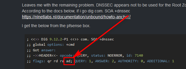

                      @Gertjan ok, so the problem
                      1. i had WAN enabled as outgoing interface, to allow the OpenVPN client to lookup the client address. I have switched to hard coded IPs and disabled the WAN interface, so the DNS Leak issue is solved.
                      Leaves me with the remaining problem. DNSSEC appears not to be used for the Root Zone servers.
                      According to the docs below, if i go dig com. SOA +dnssec
                      https://nlnetlabs.nl/documentation/unbound/howto-anchor/
                      I get the below from the pfsense box.
                      ; <<>> DiG 9.12.2-P1 <<>> com. SOA +dnssec
                      ;; global options: +cmd
                      ;; Got answer:
                      ;; ->>HEADER<<- opcode: QUERY, status: NOERROR, id: 7140
                      ;; flags: qr rd ra ad; QUERY: 1, ANSWER: 2, AUTHORITY: 0, ADDITIONAL: 1
                      ;; OPT PSEUDOSECTION:
                      ; EDNS: version: 0, flags: do; udp: 4096
                      ;; QUESTION SECTION:
                      ;com.				IN	SOA
                      ;; ANSWER SECTION:
                      com.			900	IN	SOA	a.gtld-servers.net. nstld.verisign-grs.com. 1568973101 1800 900 604800 86400
                      com.			900	IN	RRSIG	SOA 8 1 900 20190927095141 20190920084141 17708 com. nmkAwVvNUofbMMHMSogTNY2G3sUPJFKR7z+tLNS+KksACn41n0/WLMOg ZDbry+2LXMtCw0dRel0gS5/X+isD2wgNjQtKbAQRLLbBYHHpqmJWC2Yj kTw4CIr1wQUKQh63a3NN19kDTDk8uFHyyw3AFWDZcnZ7y9sd7f+vUx7o AYs=
                      ;; Query time: 27 msec
                      ;; SERVER: 127.0.0.1#53(127.0.0.1)
                      ;; WHEN: Fri Sep 20 11:52:06 CEST 2019
                      ;; MSG SIZE  rcvd: 268
                        And you see there ad set right
                        4 1 Reply Last reply Reply Quote 0

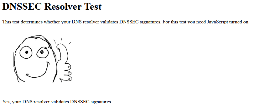

                                Also just go here with your browser pointing to pfsense for dns
                                https://dnssec.vs.uni-due.de/
                                Start the test - do you get the thumbs up?
